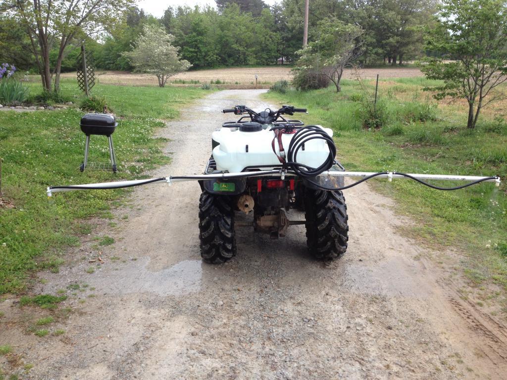

Well I got around to building a spray boom to put on the fourwheeler today. Did my math wrong though. I have a 1gpm pump on sprayer and thought I could safely handle 5 nozzles without overworking the pump but the pump is to small to handle that much flow requirements. Aside from that it works great. I have a ten foot boom and only 70 dollars in it. But will have to upsize on pumps which will be another fifty dollars.

Do they make nozzles with a smaller gpm flow that could be changed out easier and cheaper than changing out the pump?
Well I got around to building a spray boom to put on the fourwheeler today. Did my math wrong though. I have a 1gpm pump on sprayer and thought I could safely handle 5 nozzles without overworking the pump but the pump is to small to handle that much flow requirements. Aside from that it works great. I have a ten foot boom and only 70 dollars in it. But will have to upsize on pumps which will be another fifty dollars. - - - Updated - - - <img src="http://forum.mopar1973man.com/attachment.php?attachmentid=5460"/>
In what way was the pump over worked? I'm wanting to put a sprayer together too.
