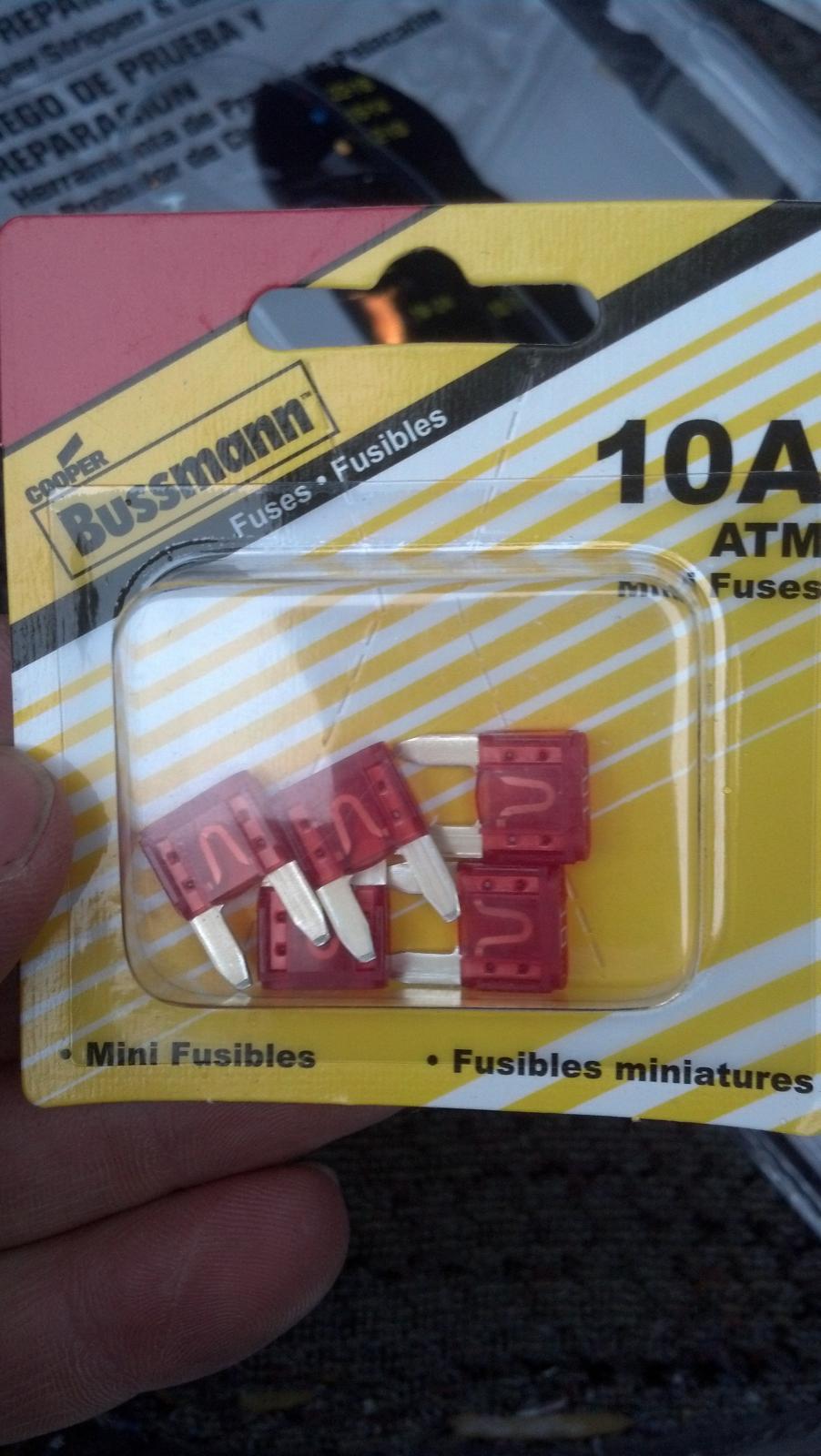

8. Two sided tape (Usually comes with gauge mount)
9. Fuses
post-1794-0-65535400-1391303470_thumb.jp

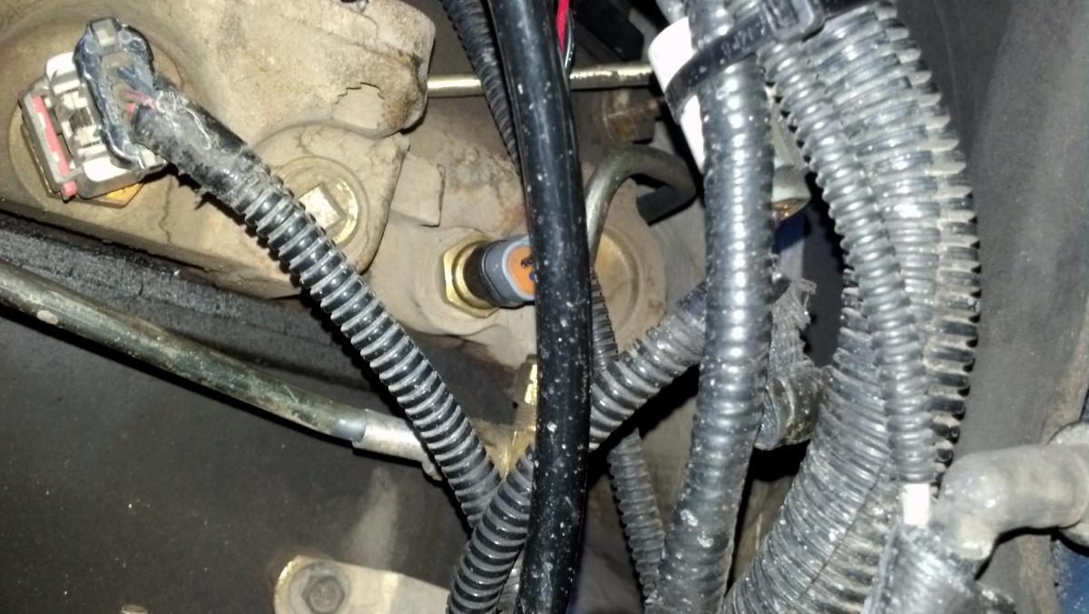

11. Run the wire that goes to the engine temperature sensor (The longer wire) down to the grid heater wire, to the injection pump wires, around the front of the engine and plug it into the sensor.
