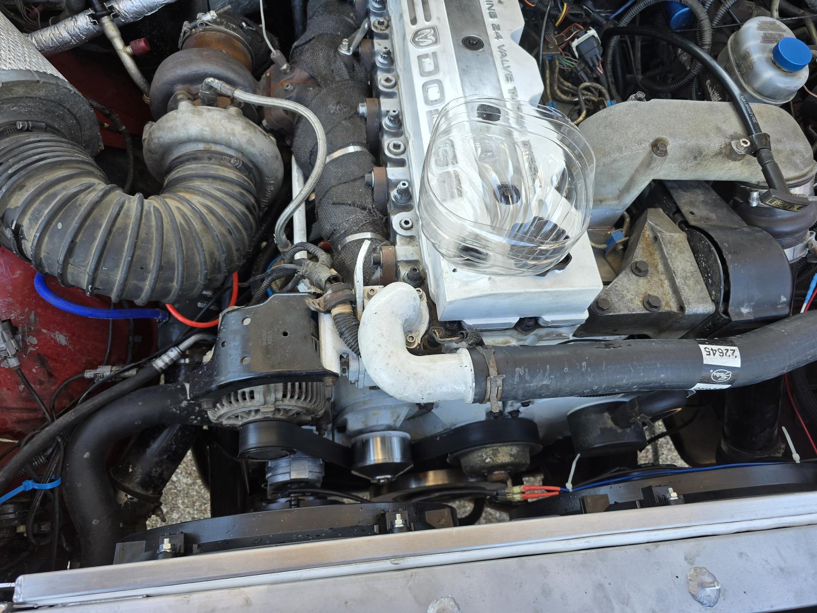

  2. Yeah the overheating was not good. Had to help a friend in need and rushed the truck a bit. I believe it was a large amount of trapped air in the head I had hadnot burped out during the cam break in. Didn't let oil temp exceed 200 degrees but I know i didn't do anything any good. And yes I replaced all the brake lines with stainless was only 185$ for the lines and about 2 hrs of work.. I highly recommend inspecting the clamp under the brake booster where it mounts to the frame. Thats where mine rotted out at the clamp holds water that splashes up from the road. The thermostat was a murry brand new 200 degree but for whatever reason was missing the little air jigglers ( small bypass holes with metal tabs in them) i think that caused it to air bind in that section.
  3. Day 1 overheat with mechanical fan ( no shroud) install electrical fan set up and wire Day 2 blow brake line going 80 mph during engine break in Day 3 transmission cooler line is severed internally ( routed different then previous and the sharp end of the tube cut the line) work loved the giant red puddle Day 4 finally find source of overheating to be bad thermostat ( thought electric fans were in effective) Today's mission find source of hard start ( fuel leak somewhere) pressurized tank to about 10 psi and got fuel from above tank no where else pulled valve cover and verified no injector leaks. Next thought is connector tube o ring but not sure how to test besides smoke on start up.

  13. So I finally have my new engine installed ( bone stock rotating assembly except I did put a tow cam in it) and im looking at engine break in procedures they all recommend towing decent weight no idle time ect all makes sense but I have 2 questions 1 ) should I run higher timing with the quadzilla to try and raise cylinder pressure for better ring seal? 2) highly contrivosal but does anyone recommend a break in oil if so what type? Ill be switching to Synthetic after the first 1000 miles and changing oil after the first 400-500 miles ( block has been sitting for years so lots of dirt and such probably in it)
