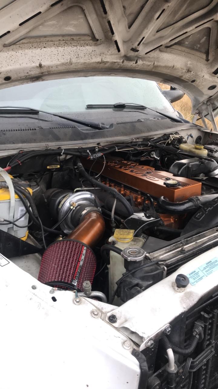

  10. Just want to say thanks in advance. This is my first post on here but have been a member for a while now. But I’m looking for some help and I have not tried searching all that much as my setup is different than most. For some reason I can’t get any better than 13mpg out of my truck. Truck info is in my sig. I am running 35x12.50 Toyo Mts on 20x10 Fuels. It has 3.55 gearing too. I am running the dd tune that’s for trucks with 50-150hp injectors but I have changed a couple things on it. Idk if it’s just the way things are setup but I hardly have any turbo lag and my truck runs good and hard but like I said I can’t for the life of me squeeze out any more than 13mpg. The truck is pretty hazy too under light acceleration. Any help is appreciated. Tune is uploaded in the pics. Thanks
