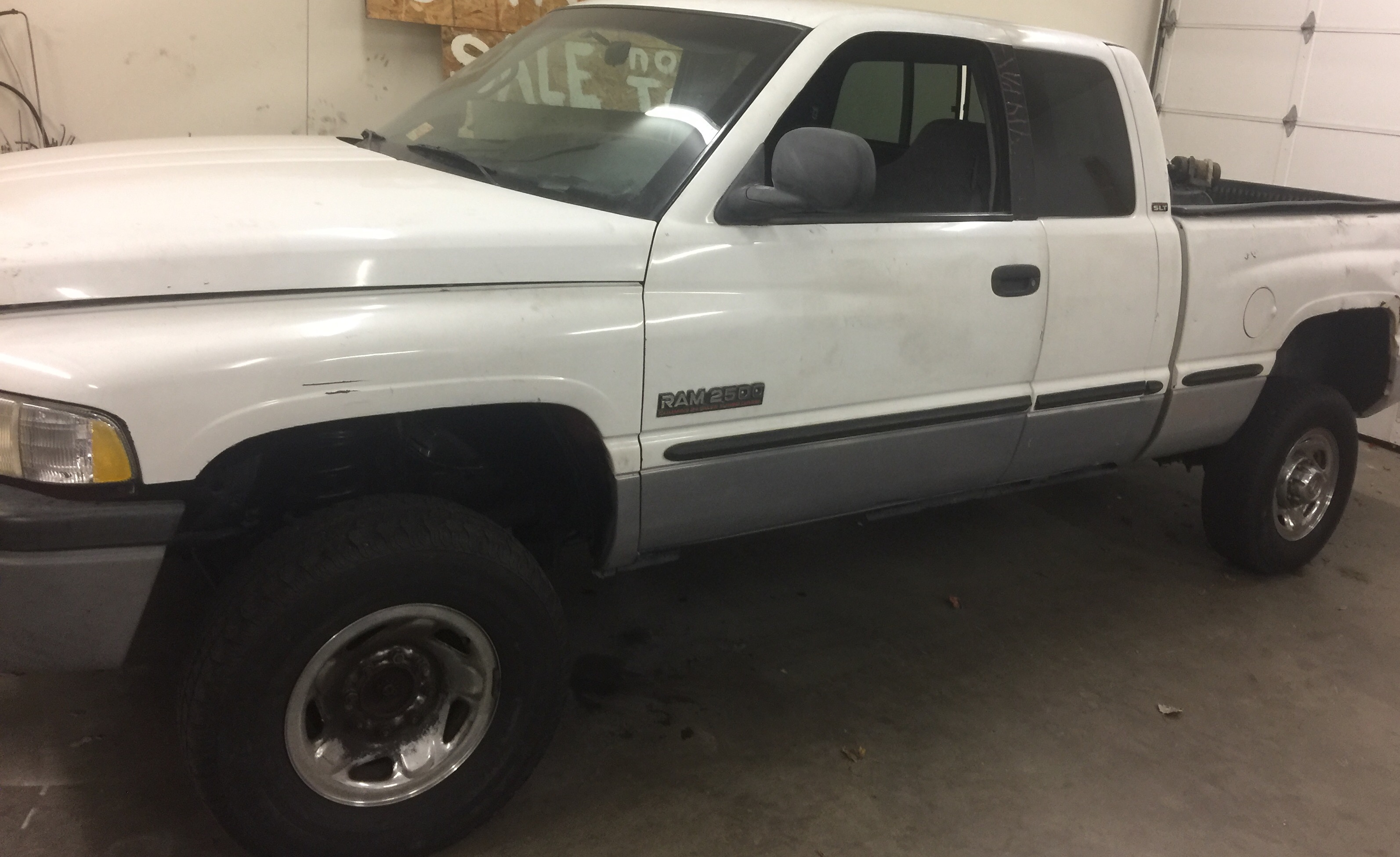

  3. Hello and thank you in advance for any help in this matter. I have a 99 2500 Ram 4wd At SLT Laramie 24v my vp44 died so I bought a complete 02 motor with a thrown rod. I put put on my 99 motor the vp44, complete harness and sensors all of them from new motor , ecm , and the fuel filter can ( newer ones nicer) pulled the cam gear off 99 and installed the 02 cam gear with the grid ring , I left the crank sensor in the hole in block ( no plug for it on new harness of course ) im still using my 99 pcm ,my tach works everything actually seems to working fine. Except the motor is running like a dog and has a idle surge from 800-1200 rpm iratically runs and drives like it's in limp mode hooked the modis up reading as a 02 truck ,and I get a 1690 code injection pump ckp and ecm ckp disagree The intake grid heater is deleted is why the other 2 codes 50034960375__8CC2E6F1-3C0E-412E-A6BD-C098E7DB684B.MOV
