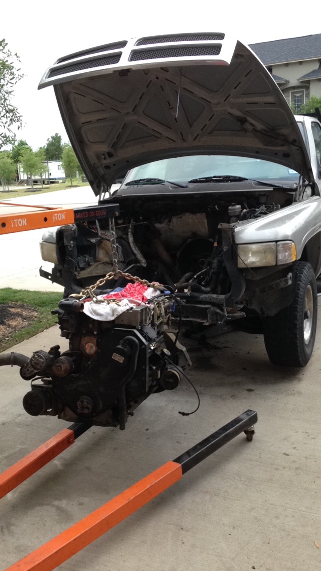

  10. 10-4 only bad thing is I had to replace the slave cylinder so I'm following mopar mans video on how to prime it but having troubles with that as well. So can't start till I get that figured out. Lol 1 problem after another.
