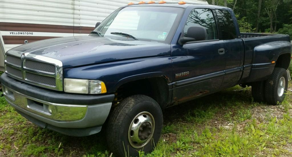

  2. Thanks for all the great info here Nighthawk. I did the swap but am beginning to show signs of trouble.I was curious about the "foolers" you spoke of. Did you have any dead pedal issues? I am currently having trouble more frequently from my throttle. I am fine in the fuel supply arena. Just have trans codes P0713, P0753, and P1763 . Will the manual trans PCM be compatible with my auto ECM? I don't have a tuner. So should I consider getting a Smarty to deal with the ECM issue? Thanks in advance.
