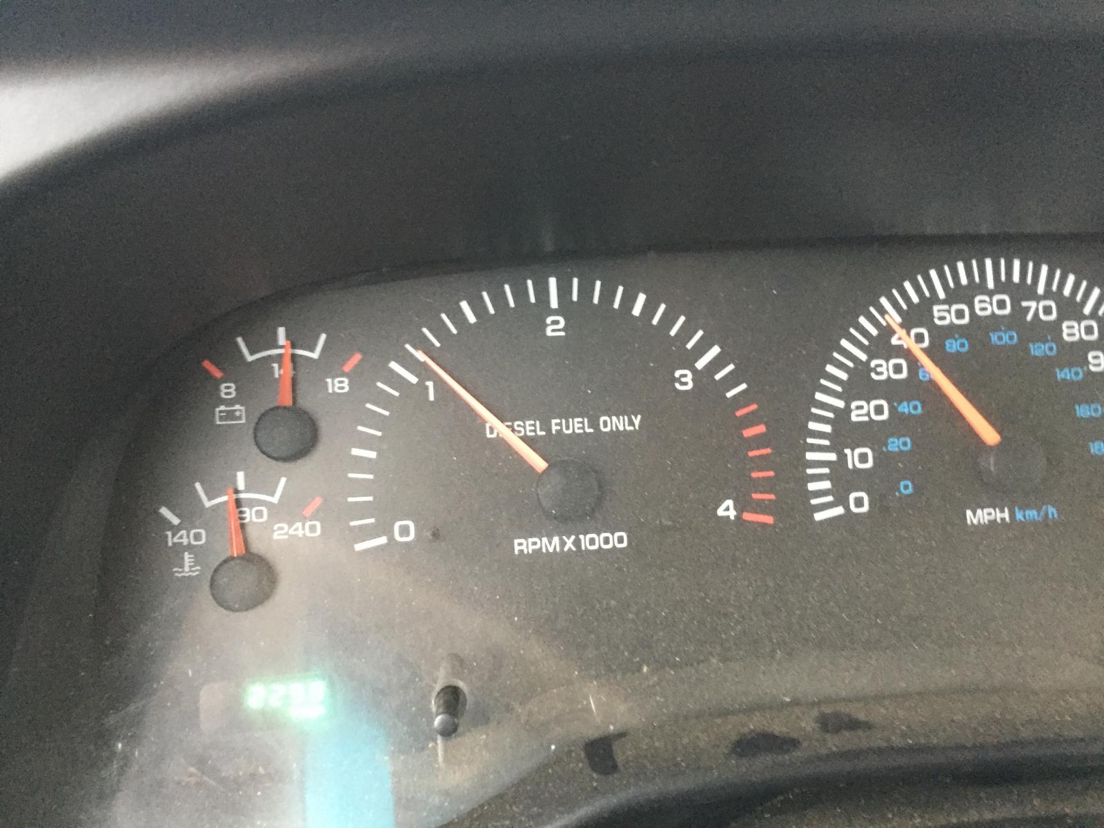

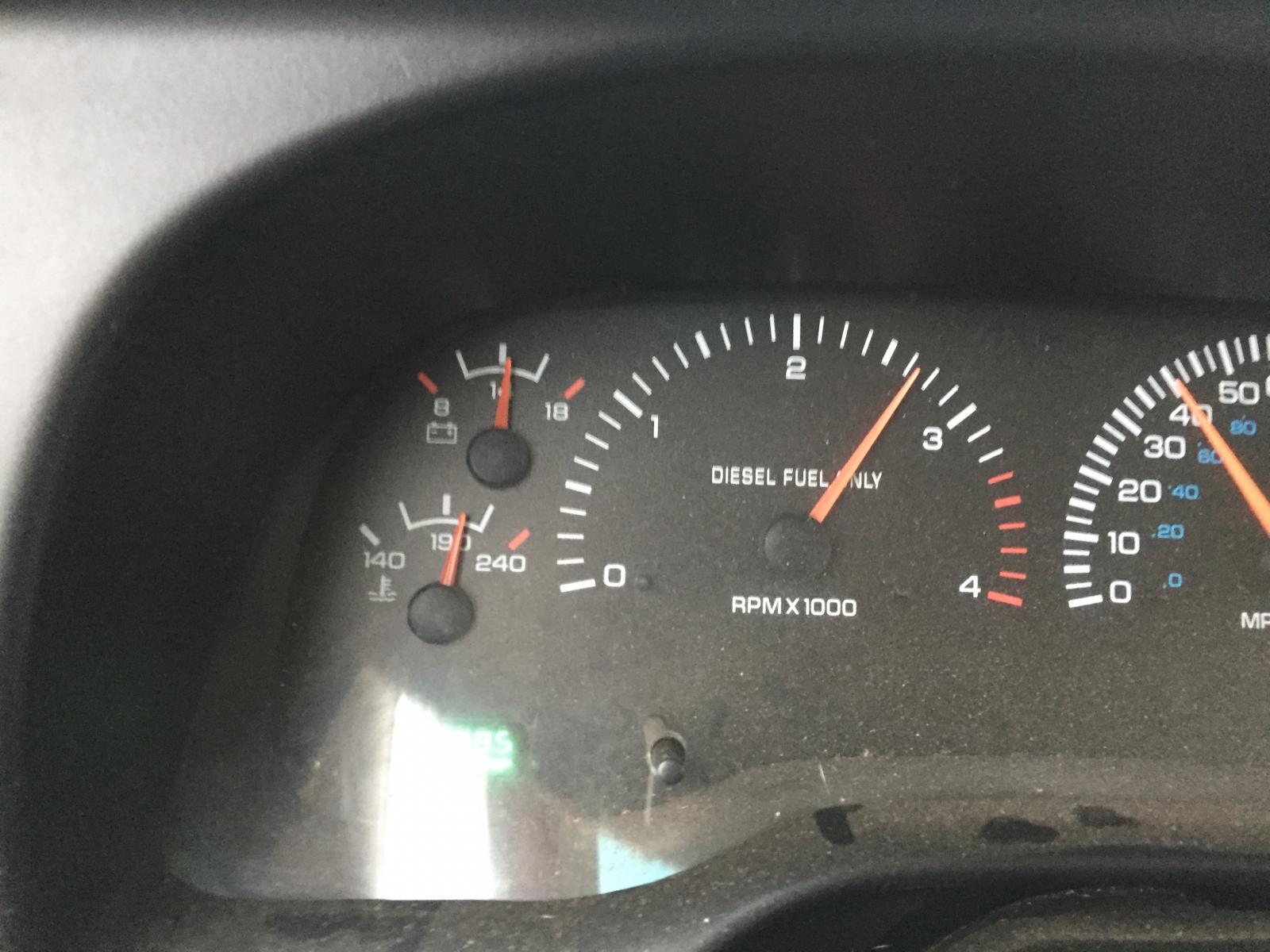

  2. I’ve been noticing that my coolant temperature has been running higher than normal at high speeds (75-85 mph, 2500ish rpm). Around town and slower highways it runs around 185-195, but run the rpm up and coolant quickly rises to 210-215. It drops down to 185 only a few second after I drop the rpm. I also tested this in 2nd gear locked @ 40 mph/2600 rpm, temp quickly rises to 215 but will fall to 185 in 3rd or 4th gear. I don’t normally drive around at 2600 rpm, but with 4.10 gears and an 80 mph speed limit it gets close. I recently swapped out the thermostat with a new NAPA 190* because it was not getting to operating temp and I figured it was stuck open. I also removed and cleaned the radiator at that time. Now I’m not liking how high and how much it fluctuates. Could it be the new thermostat is bad? Is there a recommended brand to run? Or do I have bigger issues? Thanks for the help! The truck is a 2000 Dodge 2500 quad cab short bed, 4x4, 4:10 gears, ATS auto, 60HP edge, Fass pump. A few pics of what I’m seeing:
