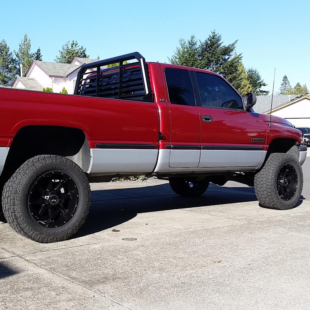

  3. No, that’s the factory two tone. Thanks Tires are 35x12.50R20, Cooper STT Pros
