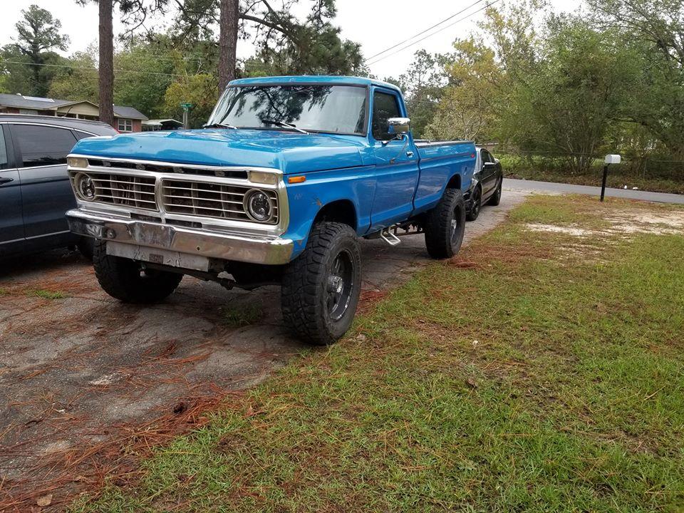

  12. Hello everyone, If you look at my sig, you will see I don't have a normal Dodge Cummins truck. I have all the looks of an old Ford, the power of a 24v, and the electrical gremlins of a shoehorned harness. My stubborn side has finally given in to ask for diagnosis help because it seems there are many different things that could be causing the issues I'm experiencing. Context: To make a long, complicated story as condensed as I can, I sold my truck because I'm moving to Germany in a few months and it would NOT fit on the roads there. I sold it to a kid on Fort Bragg and I should have known better. Zero mechanical experience but swore up and down he would learn. Fast forward a couple weeks, and he claims that the truck died at 40 mph and he had to limp it home. Since then, it would hard start and he couldn't go over 40 without it dying. Additionally, other weird stuff started to happen like a random transmission leak due to a "loose bolt" (which never happened before) and struggling to get up hills (sounds like fuel). He didn't listen to me much about it "slipping" at 40-45 mph, and had the TC replaced. It didn't solve the problem. He panicked and wanted out from under it, and I am a bleeding heart at the end of the day (for my truck, not for him). I decided to "buy" it back, less some money for my time and butt pain. What it's doing currently: Cranks over freely without starting. When it does start (maybe 1 time out of 10), it runs for about a half second and instantly dies. When it does this, I hear the whine of (what I think to be) the turbo as it unspools. I don't remember hearing this before, but I've not had this particular issue yet. It *did* have an EDGE CTS, but it stopped working before I sold it. I have pulled it out and put it back in twice, and I can't get the damn thing to power on. OBD2 port is active, and I've done a lot of troubleshooting with it - I can't help but think the problems are related. Codes: OBD2 says P1698, key bump says P1694. I had these codes since before selling the truck and it ran fine. I figured they were because of the BD Top Speed Eliminator. I will be removing that soon to see what happens. OBD2 *was* pulling MAP sensor error when the non-functioning EDGE was plugged in. Code goes away after unplugging Edge and completing the circuit. Notes: I hear the lift pump when I cycle on the ignition, though I know that doesn't necessarily mean it's sending fuel pressure. Ccd on overhead; it was there before it started dying. No tachometer, oil pressure gauge; died months before selling (figured ccd issue, maybe BD eliminator again). Codes have been there for months before this non-running issue. Replaced the cam position sensor near the VP44 (attempting to fix tach, no dice). OBD2 reader says VSS reads at 45mph on live metric data and I can't tell if my cheap code reader is confused or if the computer really thinks the truck is at 45 mph. That would obviously cause issues. Coincidentally, that is the speed at which the kid claimed the truck was having issues and died. Has brand new torque converter; shop test drove it and shifted fine, and it died going down the road. I spoke to them, and they're a reputable diesel shop - they were also getting inconsistent readings with the edge plugged in (MAP code), and unplugged (no MAP code). They pretty much said good luck kid, unless you want to pay us to help you, at which point he panicked and called me. I don't know where he took it to do an oil change, but EVERYTHING is coated in oil, both engine and tranny. I'm honestly a bit flabbergasted. What I think it *could* be out of the fuel, air, and spark equation required for combustion engines: Fuel: air in lines, bad lift pump, bad injection pump Spark/Timing: Bad ECM, bad ECM/PCM ground (Mopar man's shortened ground job completed a few months ago), new cam position sensor kaput/bad wiring Air: I'm not too sure. Actions taken thus far: Primed the fuel system. Messed with BD Top speed eliminator to see if causing any interference Next steps: I am cracking open the fuel lines today to rule out air in the lines as well as testing the fuel pressure. I'm hoping like hell it's not the VP44. Cleaning all the harnesses with dielectric grease. Pull wiring harness and ECM, send both off for repair (ouch my wallet). Could it be in limp mode? It really seems like it wants to run when it fires up, but immediately it is killed. I can't tell if the fuel/air/spark is off, or the computer is purposely killing it. Also, I'm wondering if the tranny changes have anything to do with it. Maybe output speed sensor is bad now that it's soaked in random oil. I have previously changed the ABS sensor on top of the rear diff that made the truck buck like a bull. Honestly I'm just hoping for some direction and feedback because it feels like it could be a million things at a grand to fix each. I can try to take a video later today of the start up/die and post it for more metrics. Thanks for reading this lengthy post about my fecal-show situation.
