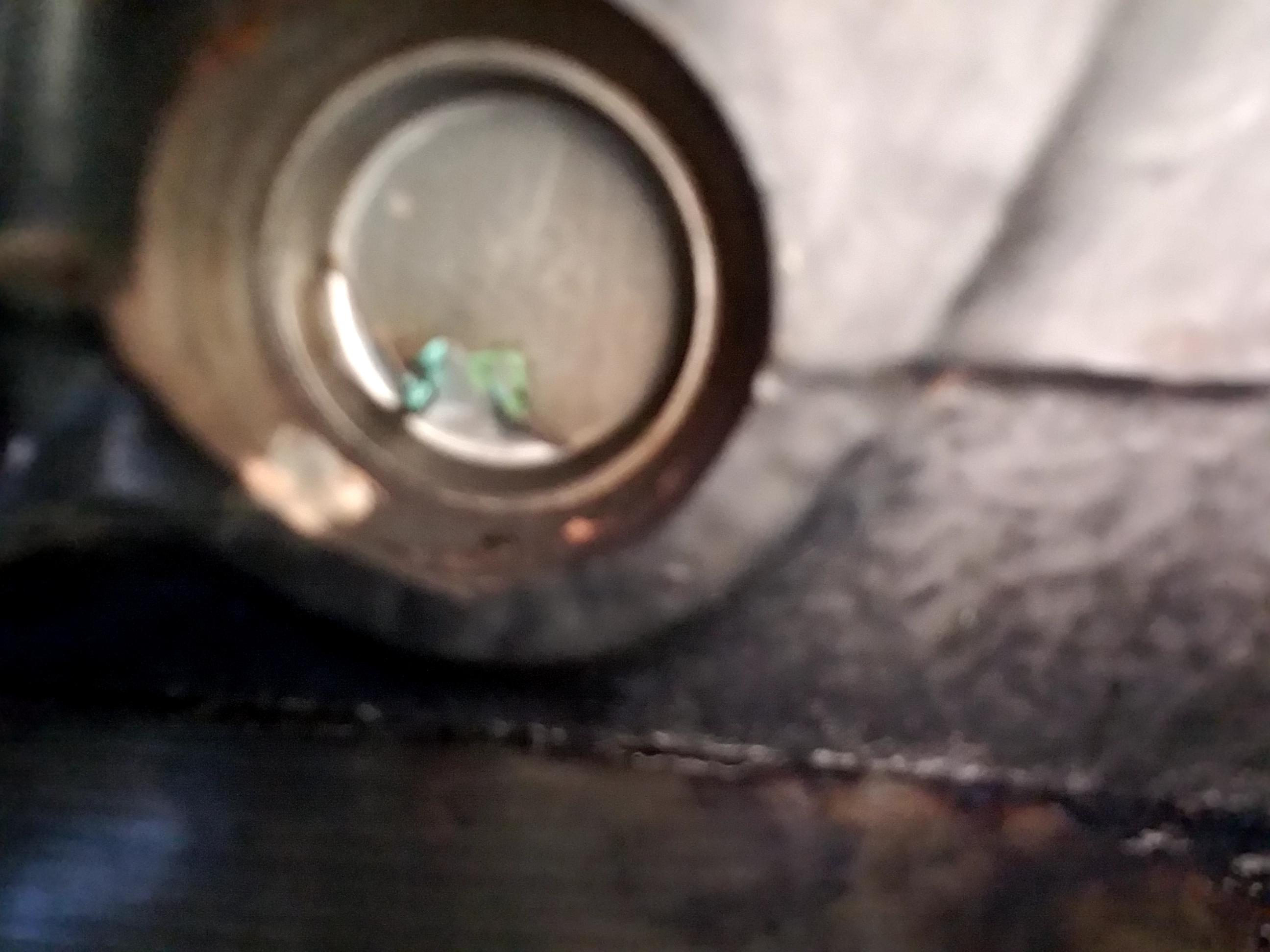

  7. Is this a small free plug next to the corner that's leaking?
  8. Thanks for taking the time to take a look. What estimate am i looking at to repair. Its a work rig and not a performance rig. https://drive.google.com/drive/folders/1GgwKBgEVNIetjNn3qND-NIrURpgbp2oA?usp=sharing
  9. more pics of mostly back of block from underneath Thanks for taking the time to take a look. What estimate am i looking at to repair. Its a work rig and not a performance rig.
  10. My rig is for my business and im a noob but learning fast. Ive spent quite a lot of $$ on it. Im hoping its not a HG replacement as that aint cheap shop work.
  11. I am up in Everett. I have been taking it to a diesel shop but pricing is too high and they never did get my AC sorted even though they charged me. So quit going there. I have an appt at another diesel shop that has very good reviews so getting 2nd opinion. Who does your work?
  12. Thanks so much for advice, i really appreciate you taking the time to reply with your experience. The tech said he did a pressure test and said it was leaking from a small freeze plug at the rear of the block. He said he had to pull the block to repair it. I appreciate advice on the pressure test . I may go ahead and do it just to satisfy my curiosity. With the motor running its too hot to feel or see exactly where its at. My main concern is to keep coolant out of oil until my 2nd estimate. then i can decide what to do.. My oil and coolant are clean and im not blowing smoke. I appreciate the advise on barrs leak. I will not be repairing the motor, it will be in the shop. 1st estimate is $2600. 2nd estimate(specialized diesel tech) if a freeze plug is between $200-$500 but that was sight unseen.
  13. Thank you for your expertise. I think that the cylinder head gasket is leaking coolant rather than a rear plug. Those pictures seem to suggest it. There is a freeze plug above that location but it felt dry whilst below was all wet with coolant. I will run the motor and check the stream 1 more time now i am more familiar with how things are situated back there. I got an estimate of $2600 to remove head and replace gasket, bolts etc and repair. That tech said it was a small freeze plug. When the motor is running i can see the coolant stream leak which is coming from that location. since its at the back next to the firewall its difficult to be exact while it running and hot. I will try not to drive the motor until i get my 2nd opinion/estimate.
