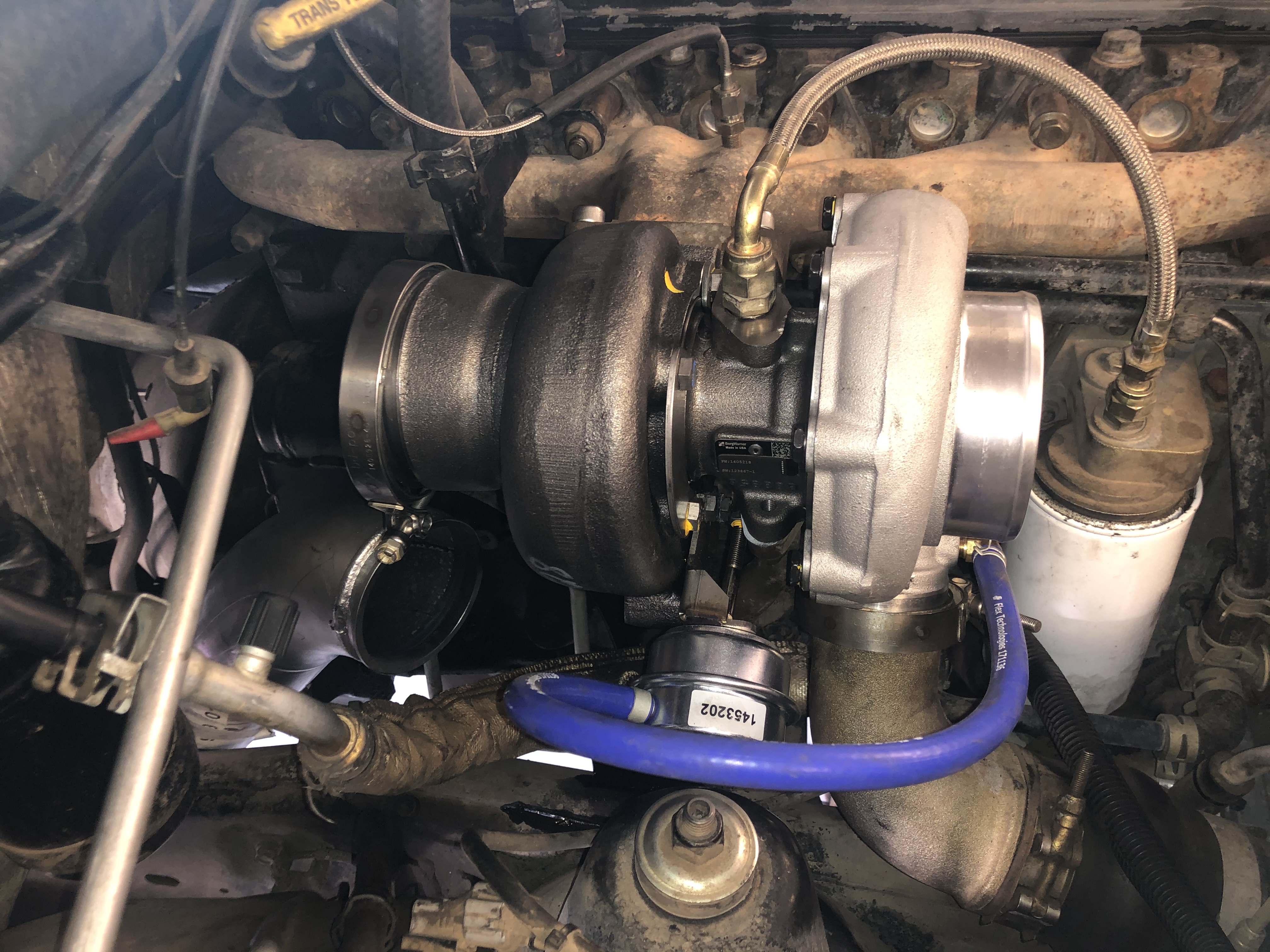

  5. Jag and tractor man, Thanks for the advice. I’d insert pics to make it easier to see what I’m saying, but i don’t see how? Anyhow, with the truck off. 1. Measured voltage between negative and positive posts on the passenger battery = 12.79 2. Measured voltage between negative and positive post on the drivers battery = 12.52 3. Truck running and voltage measured the same way. Passenger = 17.38 and drivers measures 12.17 4. Gauge in cabin reads same as drivers battery. I did remove the passenger battery negative lead from the block. A bit of corrosion, Cleaned block and terminal with sandpaper and cleaned up bolt with wire brush. This was done before the items above. I have not added the additional ground wire between batteries. And upon inspection my positive battery cable may be a bit worn. The covering at the terminals has gone from red to brownish over the years.... As far as missing something during the mod. Here’s what i did. 1. Removed ground cable from harness to 4 wire junction. Took the four wires and installed a terminal. New ground wire going from engine case as shown in the pics to the drivers battery. Ground also has the four wires at the same location. 2. Removed the cable from the alternator to the PDC. Installed shortened wire (used a piece of the original wire and installed lugs) from alternator to the passenger battery. What did I miss? For now, I’m driving the truck with the connector disconnected from the alternator. (Short drive to work) Thanks for the help everyone.
