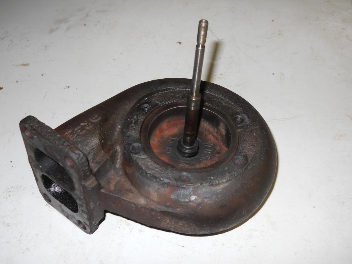

Taking the  compressor side off  was  easy..  no  heat  or  rust   to  make life fun.  BUT!...
post-980-0-46068700-1410381557_thumb.jpg    This is as  far as  I could get.    Usually,  the   turbine shroud  comes  out with the  shaft and  turbine...  I  left the  shaft behind here...

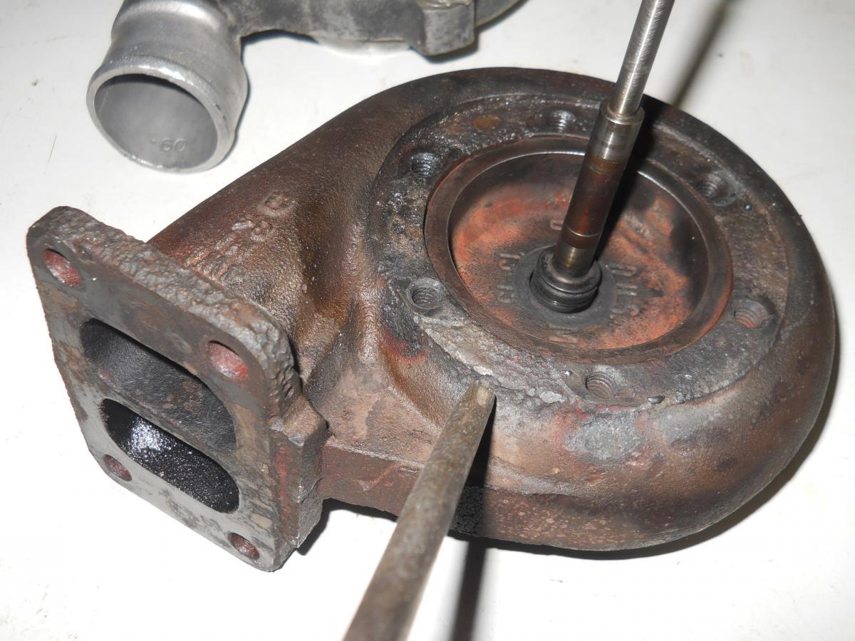

post-980-0-98819000-1410381306_thumb.jpg     The  shroud  was  really   tight/rusted/packed with carbon... take yer pick!     I heated up the  outside of the housing with a soft medium  flame...  and    gave a  quick   tap  with  a  ball peen hammer  (between  each  bolt hole)   I'm showing  the point of impact and angle of  the hammer  with my  screwdriver in the pic

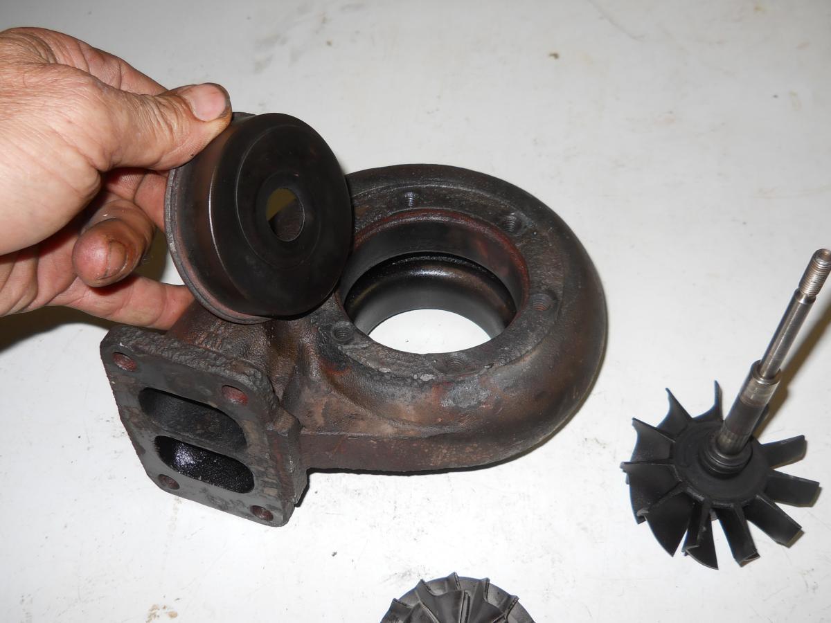

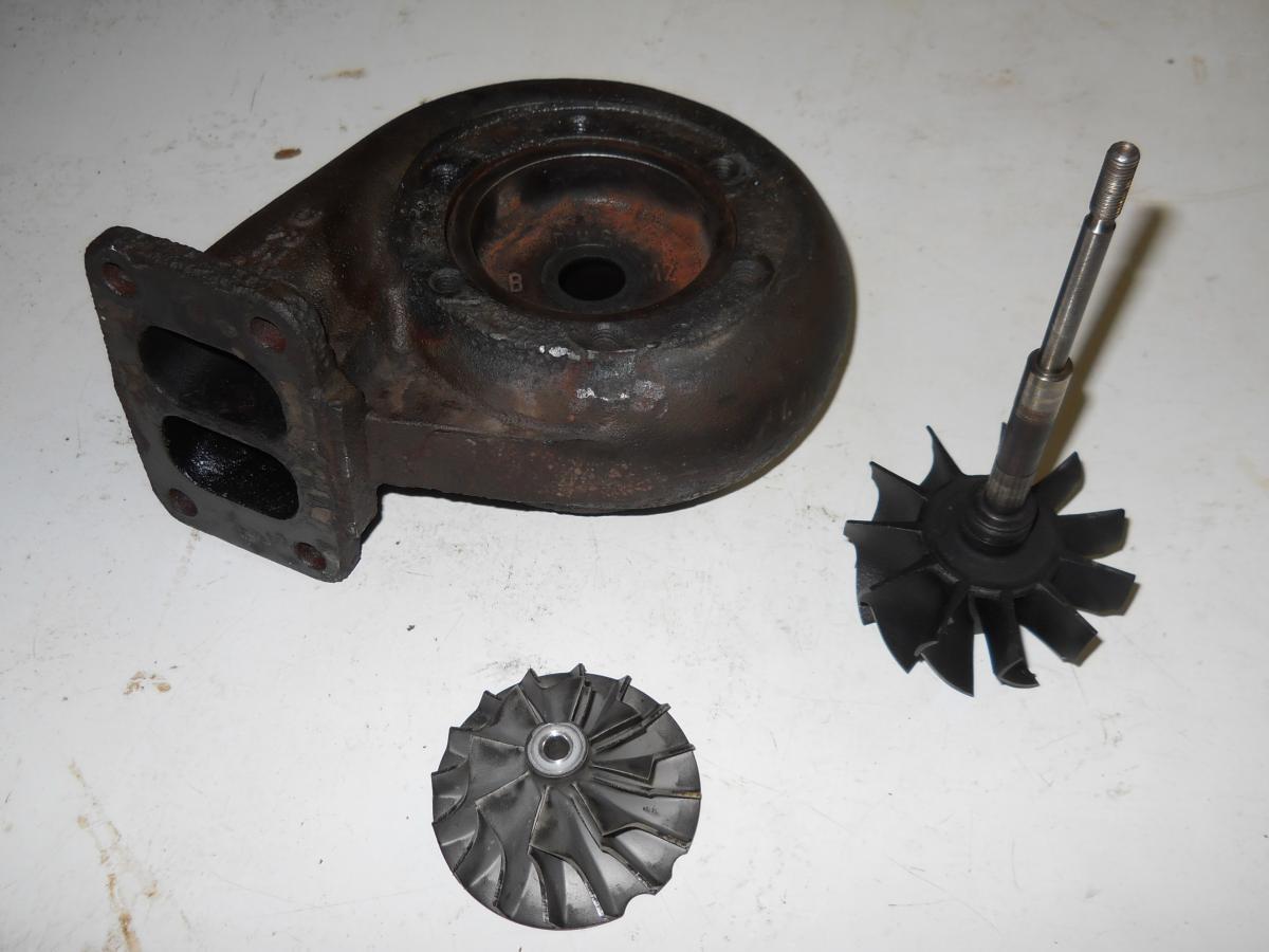

post-980-0-38328400-1410381710_thumb.jpg    a lttle tap  on the  end of the  turbine shaft  popped it out.   This is  after  some wire brushing.. geez, before all of this, I couldn't even see the parting line  between  the shroud and the  turbine housing..  It was  rusted over, making it appear as  one continuous  unit.
post-980-0-18553200-1410381165_thumb.jpg    ready for  final  scrubbing  and    I'll   fish the center housing  out of the  spirits.   should have it back together  tonight.
