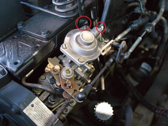

Do you have any more info on this air control vent line? I can't find anything on it on google. It sounds like it might be something for the AFC but I am not sure. Just a pic of where the line is on the pump would work but a physical description of where the line is will work as well. I am kind of doubting that fixed it based on what it sounds like that hose does, but I guess we will see.

The Air Control Vent Tube (at least in my book) has one ended connected high on the block, or head actually. The other connects to the TOP REAR of the injection pump with a bolt that goes through an eyelet on the tube. It was SO LOOSE and so obvious I thought I got lucky at that one. Feel free to
tell me to keep looking for a leak if you know better. Thanks

Are the 2 connections the same ones as what I circled? If so then that doesn't have anything to do with your fuel. I assume you didn't see any fuel leaks around it or anything either. That hose is actually for emissions in a way. It goes to the intake manifold and as the turbo builds boost, that hose runs to the top of the pump and as you build boost the is allowed to fuel more. So that line is nothing more than a pressurized air hose. You will probably have more power now that you tightened it :lol:Check all your return lines, fuel filter, etc. making sure everything is tight.
Are the 2 connections the same ones as what I circled? If so then that doesn't have anything to do with your fuel. I assume you didn't see any fuel leaks around it or anything either. That hose is actually for emissions in a way. It goes to the intake manifold and as the turbo builds boost, that hose runs to the top of the pump and as you build boost the is allowed to fuel more. So that line is nothing more than a pressurized air hose. You will probably have more power now that you tightened it :lol: Check all your return lines, fuel filter, etc. making sure everything is tight.
Yes, the one on the right of the picture, circled, is the one that was incredibly loose. That's great that I will have more power, but it wasn't really down on power anyway. BUt I will run the pressure test over the weekend and hopefully I find the actual leak. I very much appreciate all this info. Thanks again.
