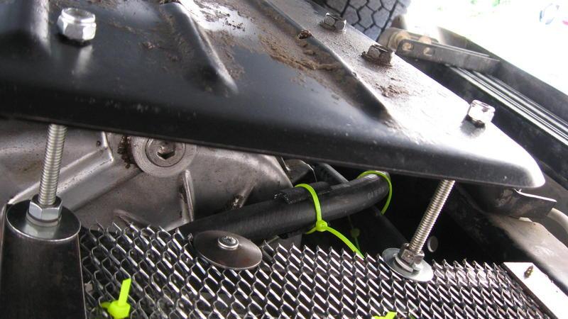

Hey guysok - here is my tranny cooler setup. Brief as possible with pics. Thanks to jim (SASQUACH).Built frame with screws/bolts and square metal tubing lowes.Purchased metal mesh from lowes also and cut to match inside of frame. Allow air in - no rocks.Drilled Angle Iron into frame with tapping screws.Used threaded metal with lock nuts in cross member so I could adjust and lock height of frame (and for removal if I need later).Attached Cooler Frame to Angle iron bolted on truck frame and threaded metal on crossmember skid plate.Cut COLD (INLET) lnlet line at front of truck directly out of OE cooler.Ran 1/2" tranny rubber hose to cooler now bolted in frame behind transfer case. Connected all up with tapered connections.Bought a sealant and 8AN fitting from lowes to go direct into tranny.Installed wiring from battery to switch in cab to tranny and grounded off frame.JBWELDED the angle iron on frame for temporary support. Will get flat bar physically welded on one non-supported corner as soon as I can.
