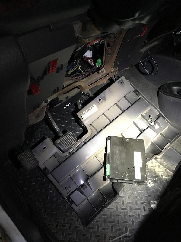

Is there a way to tell when CTM I have without ripping the dash apart?
The regular CTM has one plug connector and the highline has two connectors.
This is a highline CTM.  You can see the green and white connectors under the dash for it.
joeld79.jpg.82f8bd8587a5559446399512b5230756.jpg.4f120612dd7b3886c5891e7b18c8b12a.jpg
If your missing the second connector you going to have to swap in the highline wiring harness and high line central timer. Being there is security controls your most likely have to flash the entire system to accept the new central timer and its enhanced features. Vehicle security, key fob door locks, steering wheel stereo controls, and the overhead computer. Just a heads up with information.
Thanks guys! Looks like it's super easy to get to, right behind the driver knee pad. I'm thinking I probably do not have the high line CTM, because my truck has none of the options listed by Mike above. If I have the base CTM I'll call it a day and give up on steering wheel controls. If I have the high line I guess I'll start visiting Pick n Pulls for a wheel and the 2nd harness section.
