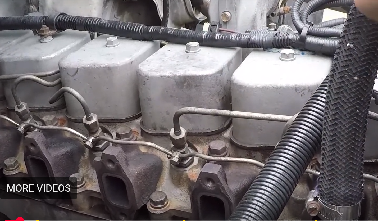

    This photo is of a typical 12 valve engine. No crossover tubes. Fuel line are connected directly to the injectors, so injectors can be shimmed. John

    My guess is that if you change the height of an injector on a 24 valve engine, the connection point of the crossover tube to injector will be misaligned. John
