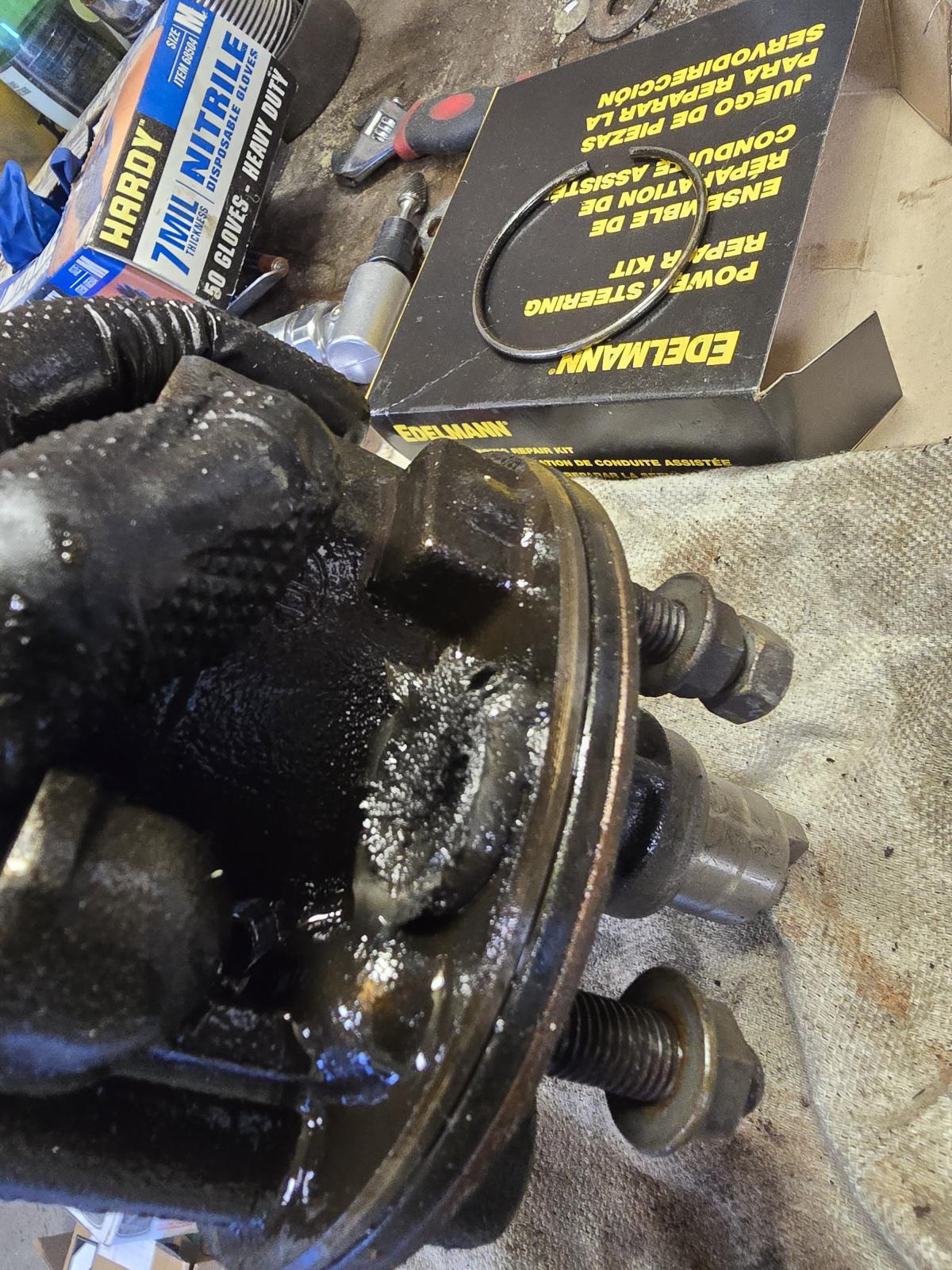

  • Thats a good point. I just rebuilt my power steering pump and was shocked how much was on the magnet especially since the only worn part i found was the aluminum sleeve the whole pump shaft rides on m
No, I haven't since this filter is on the return line from the power steering box and has the most fluid flow, I would assume the magnet in the power steering pump would have the same or lesser amount of metal on it. Besides, taking the magnet out of the pump is a lot of work that I feel is not necessary at this time.
Thats a good point. I just rebuilt my power steering pump and was shocked how much was on the magnet especially since the only worn part i found was the aluminum sleeve the whole pump shaft rides on my only thought was it must be from the gear box. Im about to find and read your original article and add a filter to mine along with a cooler.
The rebuild kit i got had one for it https://ebay.us/m/U9ICf1 I will say its a easy rebuild but not much use all your really doing is re sealing the system I never could find replacement punp "vanes"
