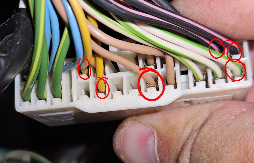

I found continuity between my positive and negative battery cables. I tracked to C1 of the PCM and verified I had continuity to ground from pins 4 and 22.  I was also lacking ground continuity on C3 pin 28. I sent both the PCM and ECM to auto computer specialists and received them back this week.  I reinstalled and all of those continuity issues have been resolved.

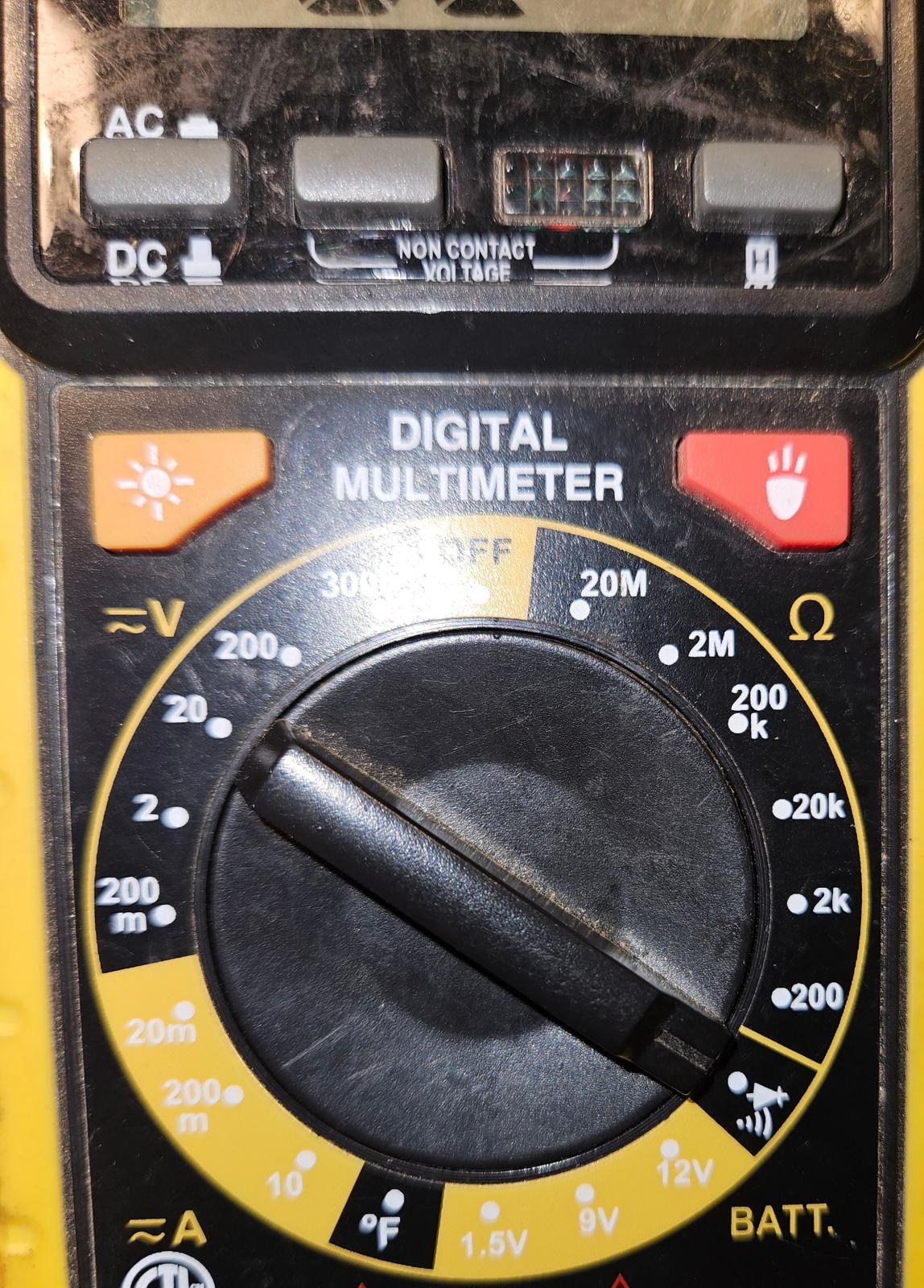

Setting shown in picture below.
I am tracking now with the batteries disconnected, however I also got the continuity tone with the batteries connected. I suspected the same regarding the dome light, but didn't understand why I have continuity with the ignition on, doors closed.
I am proceeding cautiously to ensure nothing is missed that may re-damage my PCM and ECM.
Your meter is set to "diode check" which means that current will flow only one way after it overcomes .6 volt. Current will not flow in the other direction.

So I shouldn't be worried about any of the wires circled in the first picture having "tone" to ground? What about when the engine is running?
If I should move on, I still have this throttle / power issue to resolve. Any guidance on where to focus or what sensors and target readings I should be seeing?
I can't answer that question as I don't know the purpose of that connector, or what you were trying to figure out with the method of testing you performed. If you don't know what is on either end of the connector, then any values from electrical tests performed are meaningless.

That connector is a capped joint connector combining each cluster of colored wires into a single circuit. I believe it to be J/C 8 in the '99 wiring diagrams, but the pin numbers do not match this 1998.5.
I was under the impression I had an issue because I was getting the continuity tone sound on my battery cables even with the batteries in and engine running. This doesn't occur with my other vehicles in my driveway under the same conditions.
I just thought I was using the correct setting for this, but I can certainly switch to ohms for any readings you would like me to provide. Thank you for the help!
I appreciate your explanation.
The "diode check" function is used for checking alternator diodes. The meter itself applies a specific voltage value to the diode being tested in the free-flow direction. The meter displays that value in voltage - example: .650 volts for a good diode. Reverse the polarity and the meter would read OL (out of voltage limit). Also, it is worth noting that at least one end of the diode is removed from the circuit during the test, otherwise an erroneous reading or damage to the meter (if external power is supplied) may result.
Since you were using your meter's diode test function under various uncontrolled conditions (batteries disconnected, batteries connected, engine running, etc.), you were likely collecting many erroneous readings and also you risked damaging your multimeter.
The "resistance" test (Ohms) is used for checking continuity in wiring. The meter applies a specific voltage (similar to the "diode check") and measures the resistance of the circuit being tested. The meter displays the resulting value in Ohms. As in diode testing (and for the same reasons), the wire being tested must have at least one end removed from the circuit being tested and have NO external power applied.
Don't rely on the meter's "tone sound" for testing results. Look at the display and note the actual ohm reading. There are three tests that can be performed.
