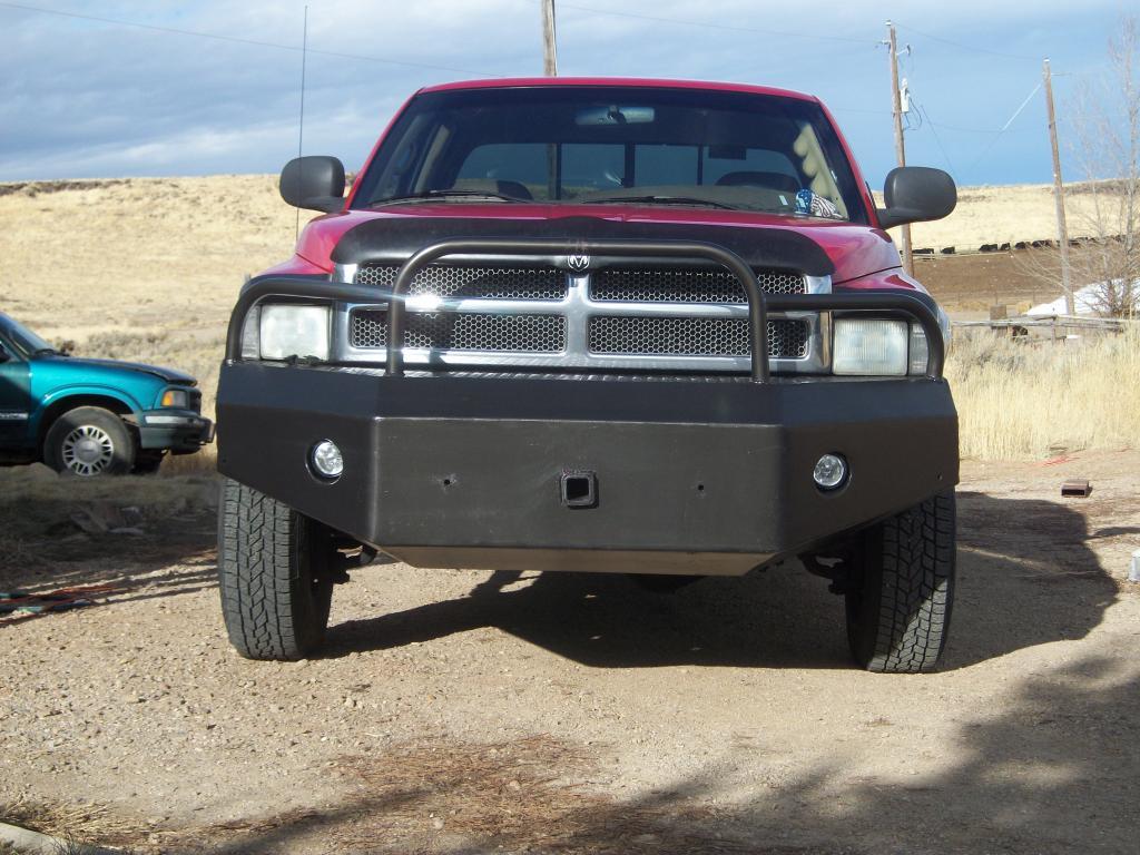

The ranch that I work on lets us use their shop, so I had some extra metal around, purchased some more metal and built my own. It is not exactly how I wanted it, but it is close and it will do the job I made it for, mainly keeping animals out of my radiator. I looked at a lot of other bumpers, seen what I liked and started fabing it. post-10349-138698188083_thumb.jpgI do have room for a winch in the future if I want to put one on, but there are a lot of other things to do before that, but like I said, I did research and found what I wanted and thought of what I might add in the future and built accordingly.
Nice! I had an idea to build one along the lines like yours. I will probably add some tabs in the front for some clevices though. I cannot fathom why in the ever-cotton-pickin world, dodge did not add tow hooks in the front! :banghead:So, did you use a 220 welder or 110?
I would have liked to have added clevices but I could not find any. I am sure if I looked around I could have found some. The ranch has a 220 wire feed welder. It is nice to have some of the right tools like a plasma cutter and oxy/acetylene, but we could have used a pipe bender also. I just took my time, made several fittings and it turned out pretty good.
Yes, a metal chop saw and hydraulic pipe bender would be something I would LOVE to add to my arsenal...
