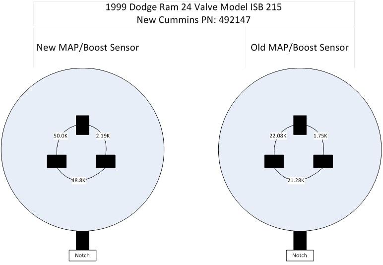

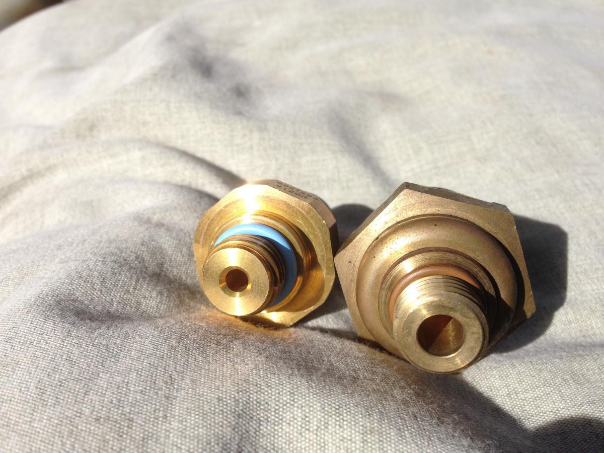

Replaced the original sensor with new Cummins 492147 (Geno's Garage) and problem fixed.   Look at the ohm readings of new and old and the opening size.
Socket size:
Old sensor 1 1/4
New sensor 1 1/16

What's weird is this should of thrown a code on the truck might not of set the MIL light but still should of set a code. If not then this is a classic case of a sensor failing within specs and not tripping a code but feeding the ECM poor data.

If anyone get time I would like to know your ohm measurements and socket size (determine if it is original or later Cummins part).
Edited by bry1216
Ohm measurement will be skewed from person to person. Why? Because it measuring PSIa (atmosphere) not PSIG (pressure). So just two people from two different elevations could possibly have two different numbers. Like sea level should be 14.3 PSIa but here at my place be roughly 13.0 PSIa.
So its best to read it with a live data tool and compare it to a mechanical boost gauge.
Closer you get to 0 PSIa is a vacuum.
