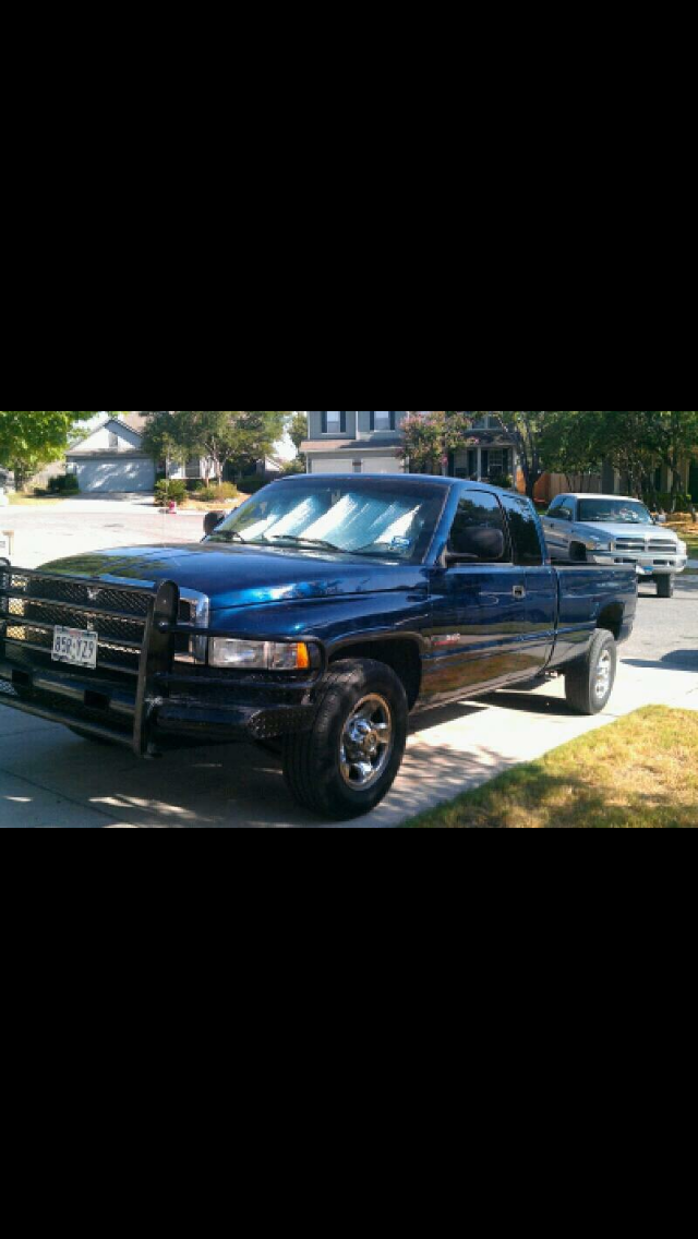

  5. So the blue one is my diesel I’ve smooshed more than a few deer and hogs with the old girl... cows smacked the passenger door... but yesterday I went got the red truck to make the ol girl beautiful again... would really love to find an old power wagon body like this to replace mine with
