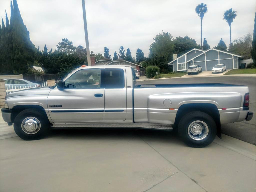

  2. Interested in this thread and can't find a better one for brake upgrade questions. 2001 dually 6 SPD manual and second set of brakes at 100k miles. 90k miles of horse trailer or 5th wheel. Need better brakes. Not buying new rim's. Truck is all stock except for fass pump. Best route?

  10. According to my paperwork, in 2001, the 1st year of the HO (245 hp; VIN 7) could only be equipped with a 6-speed and 4.10. I've never physically inspected or measured, but that's what the paperwork says. it's also 2WD.
  11. I also have a 2001 3500 dually, 6-speed with 4.10 and have 235's on it. I rarely go over 1600 rpms, I'm in 6th by 40 mph around town, and get 18-20 mpg or 450-500 mi per tank. On the highway empty I hit 2k rpms at 72 mph. Keeping it at 65 I'll get 700 miles on the tank or close to 25 mpg. This is before the FASS I added 2 weeks ago, otherwise all stock.
