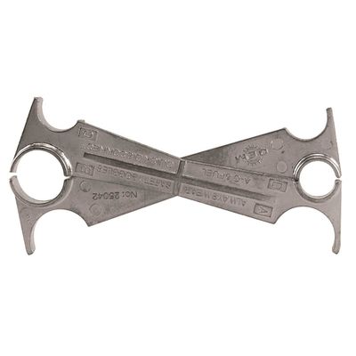

The cheap 4-way tool I had didn't fit inside the fitting even after I ground a considerable amount off the circumference.
http://contentinfo.autozone.com/znetcs/product-info/en/US/grn/25042/image/4/
I also tried these, and the one that fit properly over the line wouldn't fit inside the connector to work the spring...

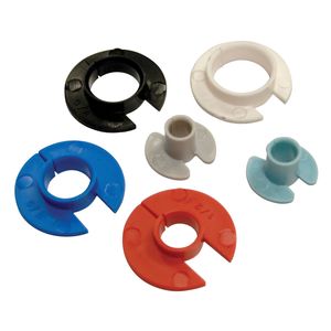

The only other set I could have tried would be the big fat plastic ring-type, but my nephew had to go home and I wasn't about to put everything back together to drive my truck the 14 miles to the nearest parts store. They might have worked, I dunno. But looking on Amazon at the "good" Lisle set, it appears that it also would have been too fat to fit inside the high pressure line. Maybe it was replaced at some point in the truck's life.
