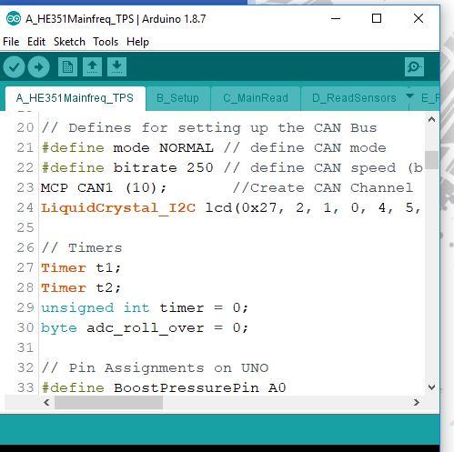

First i must say thank you for all of the help. Now for my problem im new to arduinos trying my best here i think im doing good then i hit a snags like this.
what am i doing wrong i am just trying to get to the point where i can load it to a board thanks for the help
