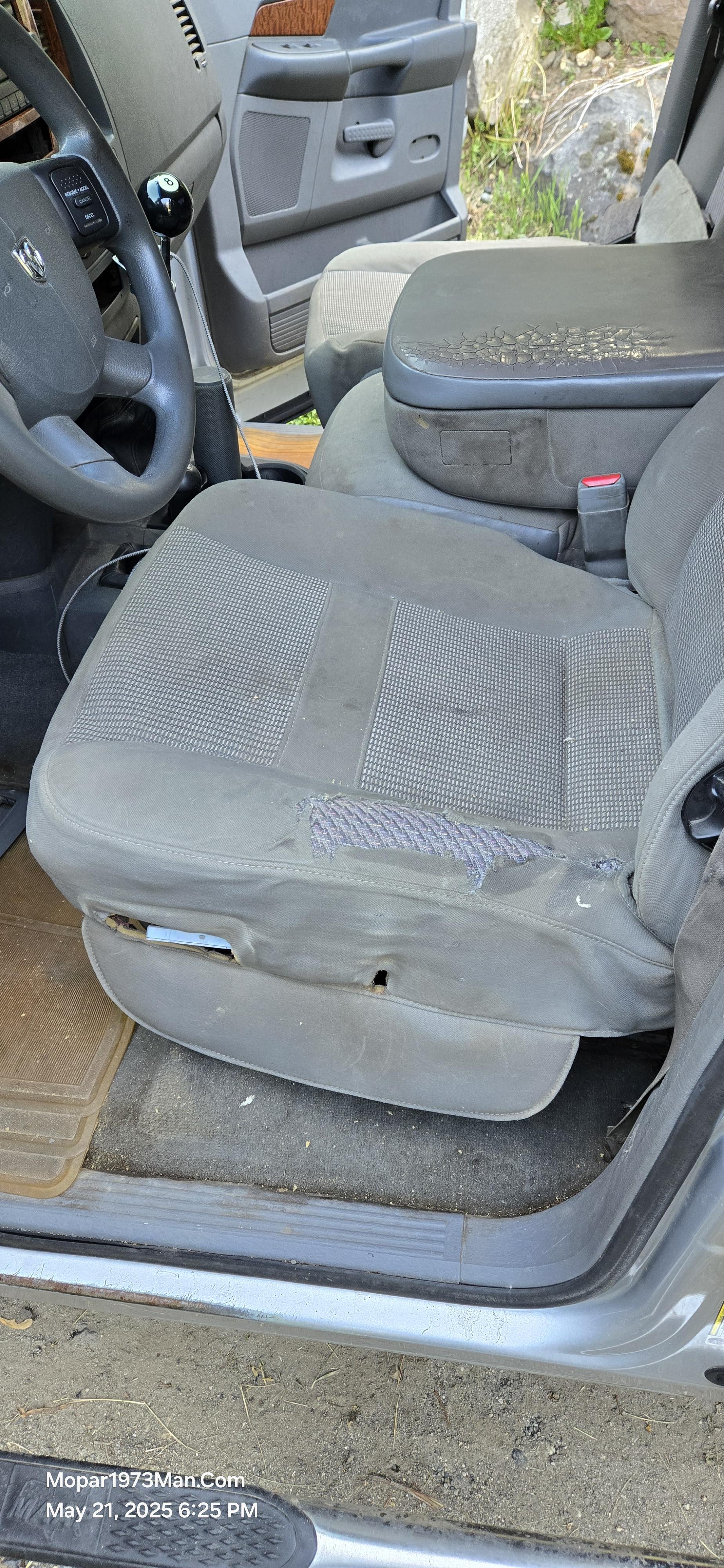

Today I bounced outside, and it was warm and sunny. I wanted to get busy trying to make Thor cleaner and comfortable. Yeah, grab the power washer and nearly a gallon of degreaser and give Thor a good washing down on the engine so I can hunt oil leaks and other things. Don't need a greasy engine. I sprayed down the door jams and hinges so I can lube them back up and get the creaky door hinges to stop. The driver seat was pretty bad I peeled the seat bases out of both sides. Not really hard, just need to be sure to unhook each hook on the frame of the seat. You'll see in my photos I took an old 2nd Gen Seat and chopped up a chunk of foam from the 2nd Gen passenger seat (salvaged truck). Now I slowly pieced the seat foam back together with Gorilla Spray Contact Cement. This worked out great for binding foam together. I also cut a chunk of fabric out of that old 2nd Gen seat and used it to fill it.
When funds are available I'm planning on purchasing the new seat skin and the foam pad both...
