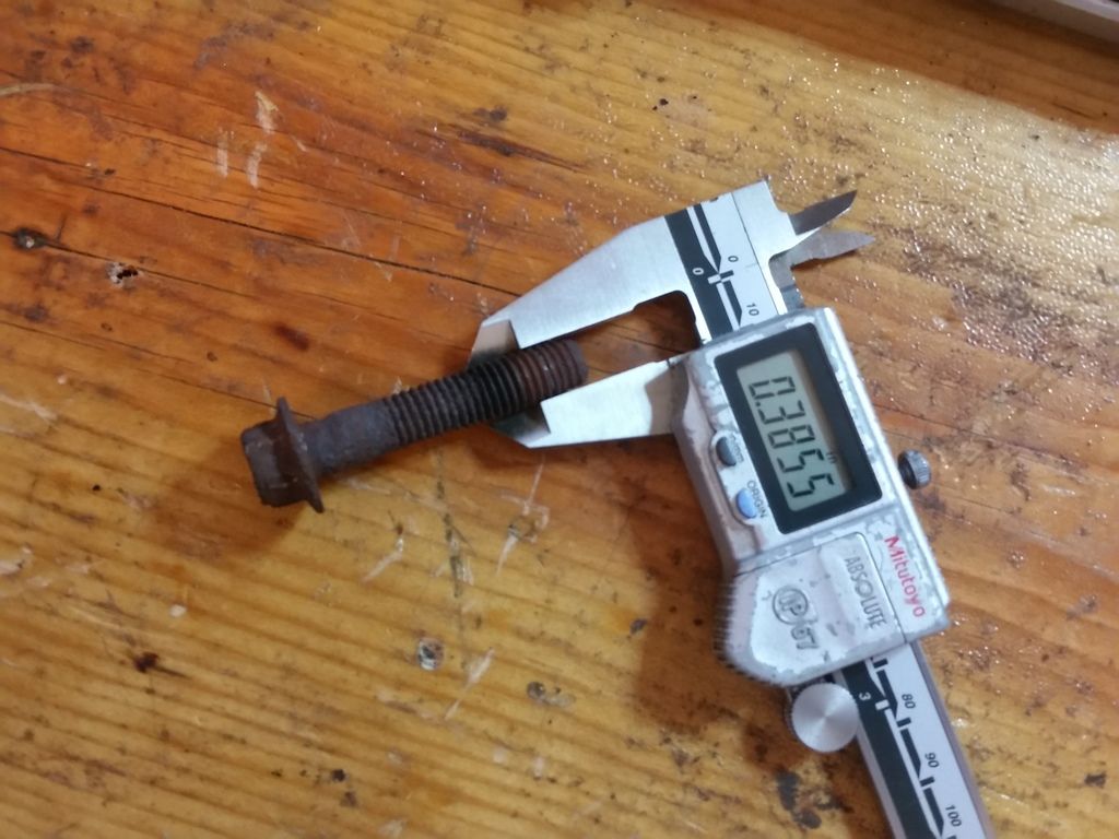

Here ya go,  I happen to have pulled mine off today.
I think they are metric but I took both for you
Length ~ 60 mm
Width ~ 10 MM
Pitch - 1.5 mm
In standard
Length ~2.3"
Width .38"
thread per in 20
Yes they are metric M10 x 1.5 x 60
