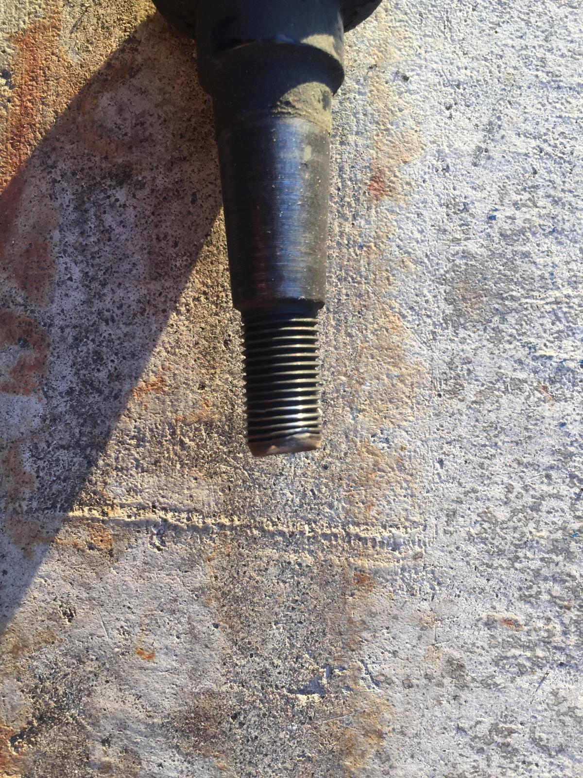

  • For those who see this thread and do some off-roading, I would definitely recommend having some sort of leveling kit or cutting the stud off of pitman arm joint. On a stock height truck, a couple inch

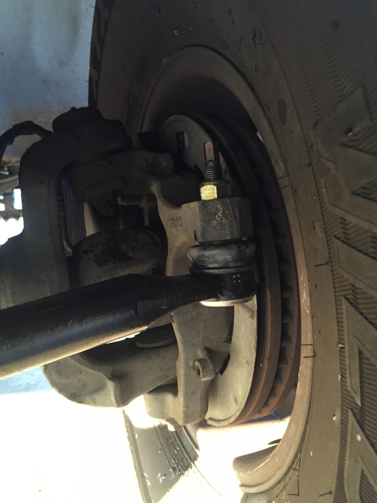

I got got my kit out on today. Went pretty easy although the old TREs needed some heat and some good whacks from the hammer. I managed to mangle my threads on the stock steering stabilizer so I'll be running without one for a while. I ended up having plenty of clearance for the TR threads but the part of the tie rod that holds the end itself was pretty close to the dust cover. I had maybe an inch of extra adjustability in my drag link before I was as short as it could go.

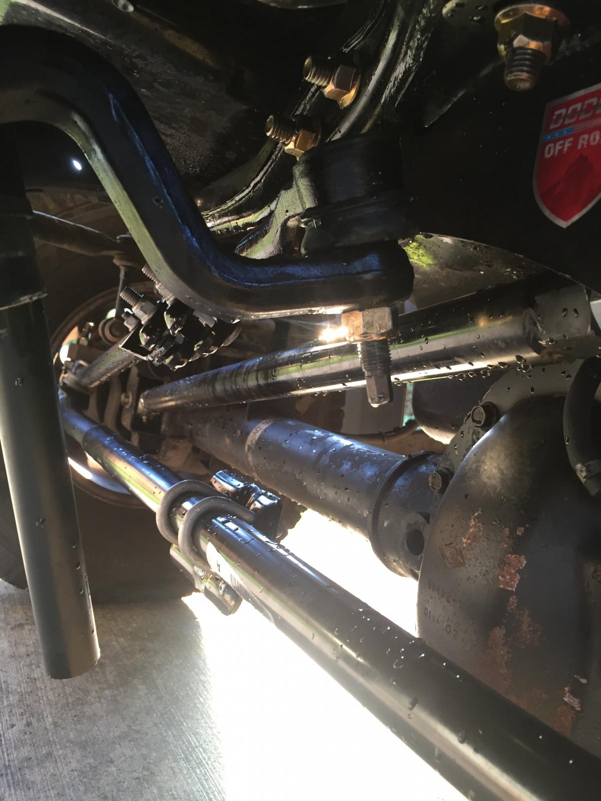

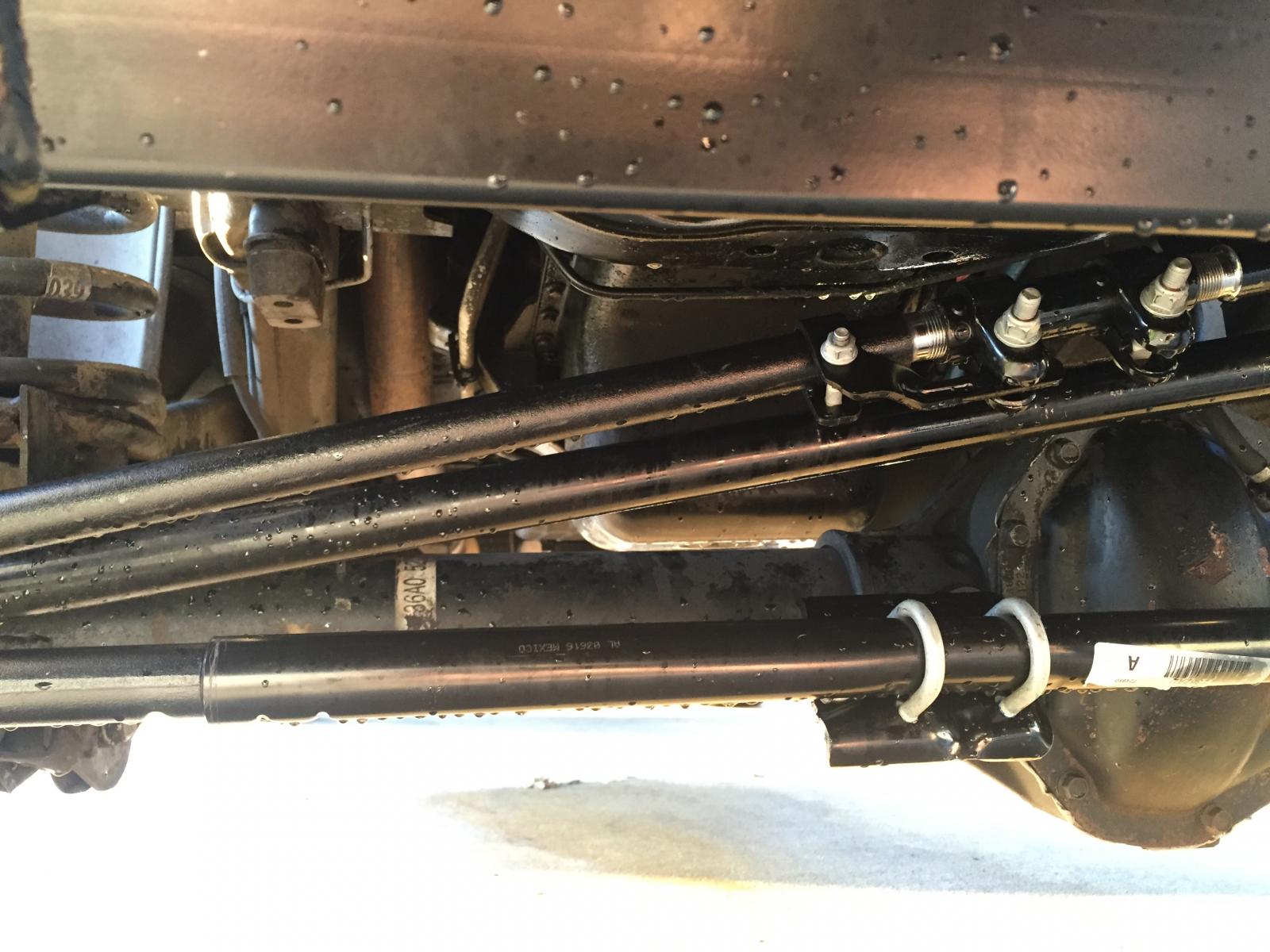

Here's some more pics to give you reference of how things sit.
and my my poor steering stab! :doh:
Cool. I took mine to a little pile of dirt and put each wheel up on the pile flexing the suspension to make sure nothing rubbed and tried it a various wheel positions then did the other wheel same thing.
The only spot ggat was close was the tie passenger side sway bar link but it didn't touch and i was flexed out pretty good.

If u don't have the 2" leveling kit i would be very carefull with this set up. Make sure you test it like i did for clearance.
That was with the sway bar off... Man it works so good off road with out it.. Lol
