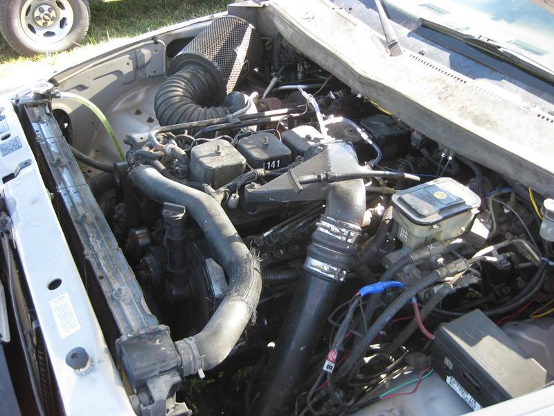

I was standing on the drivers side and looking at it and it just looks so empty lol. Had to take a pic of it. Not sure what you mean by crappy mic, I can hear everything perfect so turn your speakers up lol.--- Update to the previous post...Well, I saw more unneeded crap, and the overflow tank was too tempting. I went all last year without a fan and never noticed it gone so why not rip it and the shroud off too lol. I just went for a test run driving it really hard and just as I figured, it didn't notice a thing. The a/c gets hot at stop signs and I think it is bad if you have the a/c on and no flow through the condenser, but I am a few cans short of enough freon so I haven't used it all summer. See anything else I can get out of the engine bay?

I don't think that tube bends at all. Preformed or something. I'm pretty much set on that side, the drivers side is the one I wish had less stuff. Would work good if I could move all the braking stuff somewhere else, then I could get to the whole fuel system reallllly easily, right now I always have to reach around it. I took the engine out just so I could heli coil the AFC housing because I couldnt drill and tap it straight enough with the brake stuff in the way. Ok it was partially just to see the engine out of the truck too :lol:
Getting a little carried away now. Got rid of all the wires for a lot of stuff. Rerouted them so they wouldn't be in the way. You can see I moved the grid relays next to the fuse panel and ran the wiring along the cowl. So heres a before and after.
