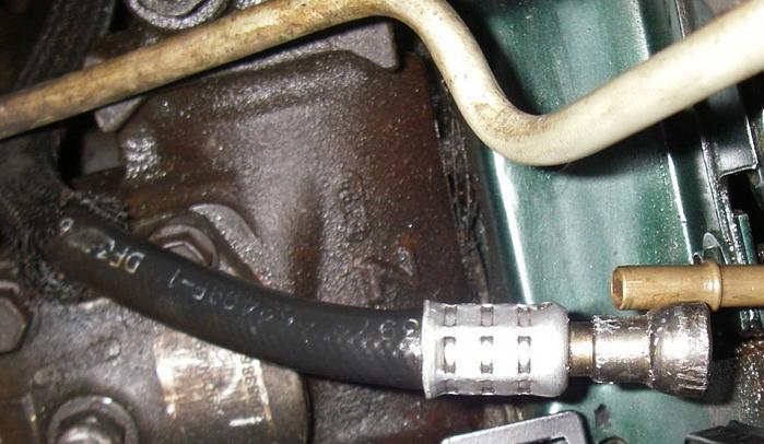

Deinstall Transmission Line from primary Cooler
How do I decouple the hardline from the softline aout of the cooler. Similar to below (taken off web - not a dodge ram)post-10132-138698169355_thumb.jpgI have the retaining clip on - but can't seem to get the hardline out. Do I just pull or is there something else ?? :shrug:I am decoupling to install a soft line from my AUX tranny cooler in back - thanks
  • Replies 3
  • Views 3.4k
ok got it off. With a screw driver there is a little compression/retaining clip behind it.
Sucky thing is I think I have to cut this whole section out back to the hose - as the parts/adapters I have with the cooler kit are NPT thread - so I guess they intended it to go straight into the hose and then clamped down.
Make sense ?? :shrug:
