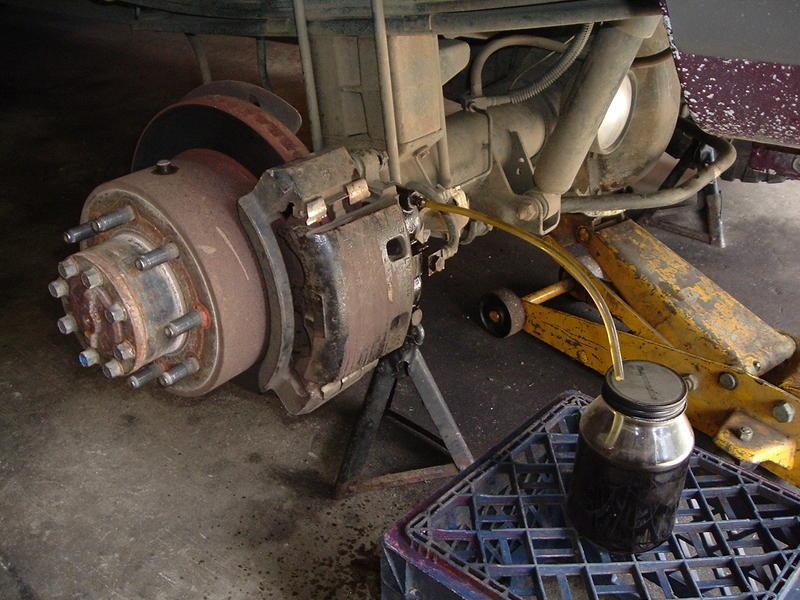

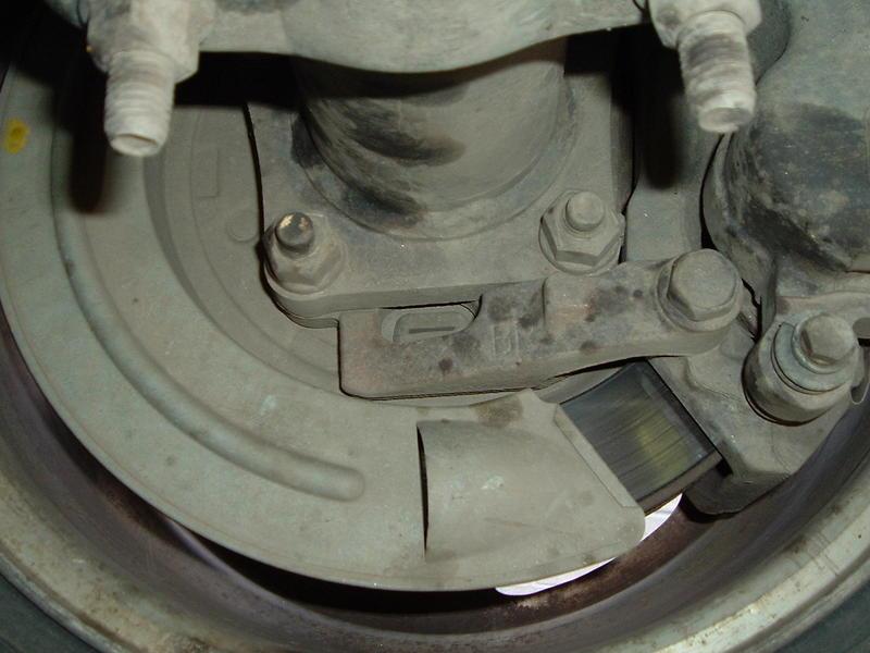

[ATTACH=CONFIG]1917[/ATTACH][ATTACH=CONFIG]1918[/ATTACH][ATTACH=CONFIG]1919[/ATTACH] Rear axle... 2001.5 and up where all 4 wheel disc brakes...

Yep like Mike posted, The rear park brakes are a drum brake and adjust up the same as any other drum brake. Its just that the drum happens to be way smaller and incorperated inside the wheel hub. It is possible and also likely that the cable has stretched also and that can be adjusted seperately as well but only after the shoes have been set up.
