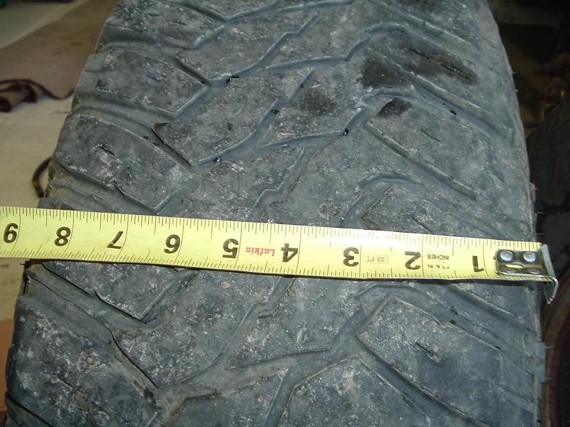

So that explains why some drop the 315 tires on trying to get the gear ratio back down to 3.55 gear by changing tires... But looking at thes pics will enlighten you a bit. Just the ~20 pound reduction gain me roughly 2-3 MPG... Rotational mass and rolling resistance plays a big roll in MPG game. Big O AT 235/85 R16post-2-13869817186_thumb.jpg Cooper STT 265/75 R16post-2-138698171585_thumb.jpg Comparing the Cooper STT 265/75 R16 to the Big O AT 235/85 R16post-2-138698171865_thumb.jpg

I wouldn't have thought those would be a 20lb difference
People wonder why the ricers get 30-40 MPG... They got tiny tires and the weight of the tirees are no more than maybe 30 pounds, have little to no rolling resistance, rotational mass is by half. Then even with my 7,900 pound truck on the scale I still touched a high mark of 25.3 MPG... My typical is 21-22 MPG. So if you going to aim for the actual MPG mark and not going to be towing it would be better to change the gears out for 3.55 gears. But if you towing heavy I would leave it alone.
