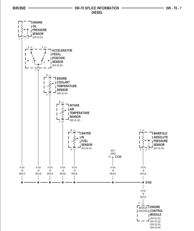

Are you familiar with the W-T ground reference modification? If so, have you done the modification? This modification addresses a potentially poor ground splice for the ECM and many other components. It addresses other wiring issues, as well. The wiring diagram below shows how many components use this splice.
