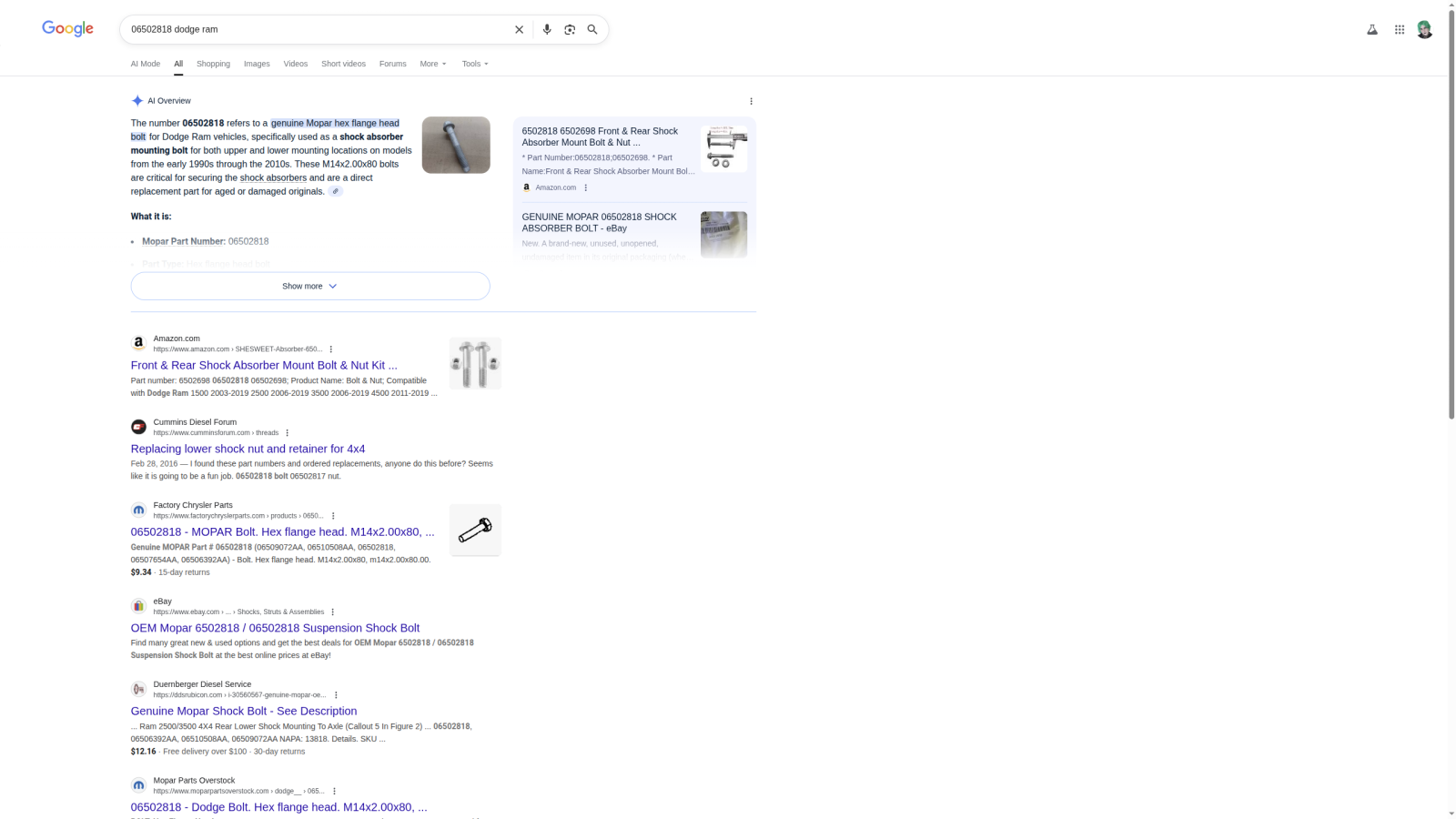

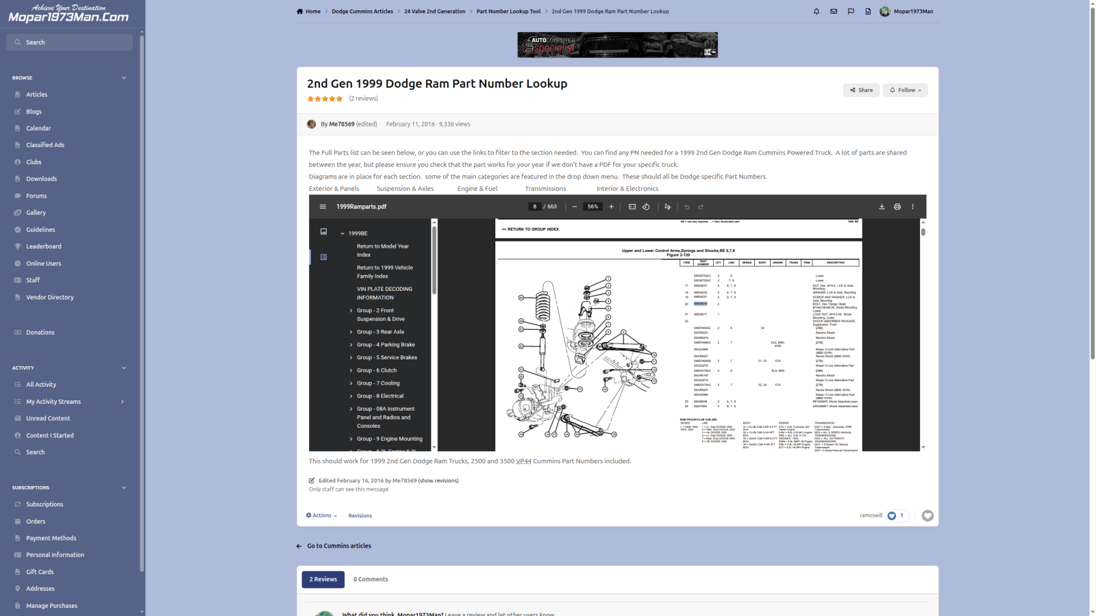

    Here is a trick for next time I found the bolt part number and also the bolt size... BOLT, Hex Flange Head, M14x2.00x80.00, Shock Mounting, Then go back to Google to look up the part... Then selec
  • The bolt has worn thin so the sleeve isn't tight around the bolt I fitted new shocks they started knocking a few weeks later. This was a few years ago now truck has been pretty much out of service unt
4x4
Then go back to Google to look up the part... Then select a supplier for the part. I see Amazon and a few others...
Thanks I will try order some through Amazon US
