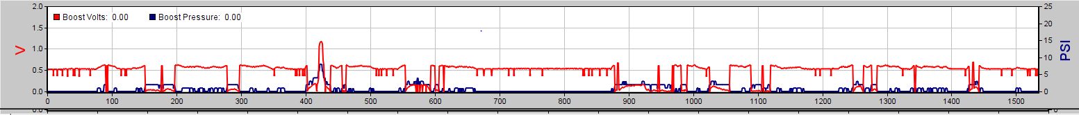

Test drove it just now. This was with the intake heaters disconnected from the battery. It seemed to run fine, but the log I've attached shows the IP voltage dropping and spiking as well as the MAP sensor (boost voltage) was dropping out.

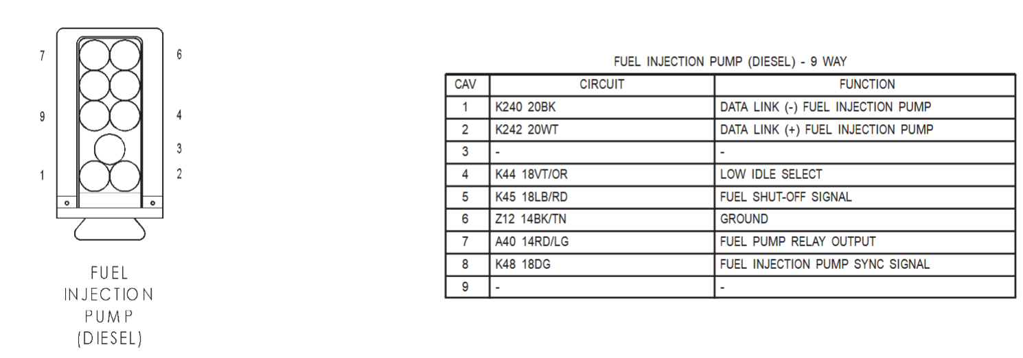

If you have the W-T ground wire mod. Then the ground for the VP44 is at the gear case otherwise the ground is the passenger battery terminal.
Use the wiring diagram and test the wires from end to end should have 5 ohms or less to pass.

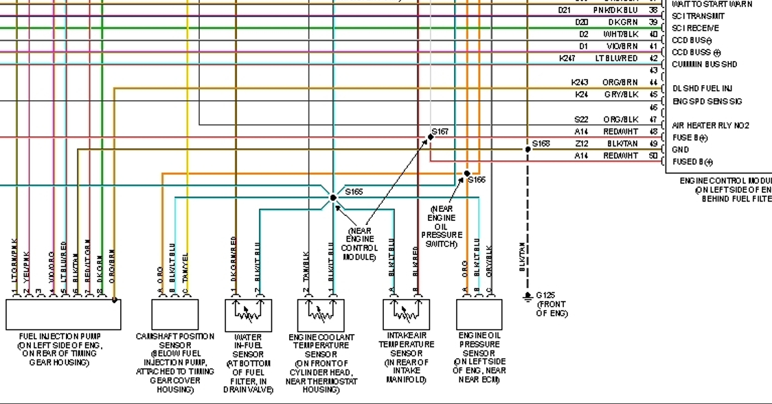

Are you referring to ground splice 168 (top photo below)? If you are, then the W-T ground mod wasn't complete. This splice is disassembled and all wires are routed to the front gear case cover with an additional wire to driver side battery ground (see bottom photo).

Yes, that's the one. I thought the W-T mod had been done because the wiring going to the alternator had been modified, but I missed that they hadn't done the 4-wire connection. There is a 2nd wire coming off, but it goes to the ground on the top of the front corner of the fender (original location?), rather than the battery. I'll reread the W-T mod article again and try to get it all through my dense head.
I haven't cleaned the ECM connection or checked the wires yet, but there have been some changes. The log below still has the dips, but they're not random, excessive and short like before. Now the dips coincide with when I'm accelerating and getting boost. Truck ran fine.
I backprobed the MAP sensor connector had a Fluke 177 hooked up to that wiring, positive at the connector and negative at battery ground terminal. The meter never showed any of these dips. The slight increases at moderate acceleration did show on the meter. A mechanic buddy recommended I use the MIN/MAX feature since the digital MM might smooth out dips, so I did a run using that, and it never showed the drops down to just above zero. Min was like the shorter drops adove, at 0.321V. I also hooked up an analog multimeter, and it also didn't show dips to zero.
Regarding MAP voltages, I read that the values are supposed to be between 0.5V and something higher. I get 0.51V at key on engine off. Once I start, it frequently is dropping down into the 0.4+ range and staying down there a bit, although it doesn't look like it on the graph, other than the dips.

Yeah, if it weren't for this log, I'd think all was well. But if my main diagnostic software looks like this, I'm not happy. I've not pushed it yet, though. Just traveling easy around local roads @ 45mph max. My 1st shudder, and it was a biggie, happened when stomping it on an entrance ramp.
