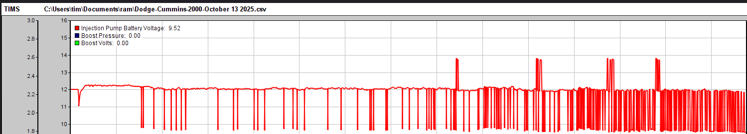

I have AutoEnginuity, so got the Chrysler enhancement package and found a few things. The MAP sensor checks out with 5.2V key on engine off. Test run yesterday, backing out of the driveway the voltage dropped to 4.93 briefly. Once going down the road, it stayed above 5V and responded seemingly correctly to acceleration. I suppose that the brief drop below 5V would be enough to throw a code. Let me know if otherwise. I haven't tried bending the diaphragm yet as described in a HOW TO DIAGNOSE VP44 FUEL SYSTEM ISSUES document.
Another thing I noticed was that the VP44 input voltage was dropping from 12.18V down to ~9V. Occasionally it would jump up to 13.5V, which is what I was measuring at the battery when it was running and the alternator was charging. 12.18V was what the battery read before starting. They were brief excursions either way, but it got progressively more frequent going down to 9V as my test drive went on. I can log and provide these charts.

I re-read all of your posts. Do you still get voltage fluctuations at the injection pump, especially under acceleration? If so, those low voltage readings on your original graph could cause the fuel solenoid to misfire.

The photo below is from one of your earlier posts. I would be specifically concerned with re-checking the voltage to the injection pump. Voltage falling down to 9.5 volts could easily cause intermittent operation of the fuel solenoid valve in the injection pump resulting in random injection events not happening. This does match your symptoms.

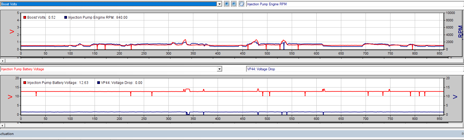

Here is a log I ran tonight. I had several accelerations where it cut out, some multiple times. Every significant acceleration had cutouts. Some patterns here, but not 100% consistency. Battery voltage @ pump has improved, but still has drops; they don't match up with the cutouts though.

The bottom horizontal scale is the number of lines done during the log. Looking at the CSV file (attached)ueoa, a read is done every 180 milliseconds, and with 4 datapoints captured, each line is ~750 milliseconds.

"Volt Drop" + "Injection Pump Battery Voltage" seems to equal 14.00 volts, give or take a couple of hundredths on your graph of over 800 reading covering a 10 minute span. On some readings where the voltage is low (10.9 for example) adding the "Volt Drop" doesn't bring it to the 14.00 volt value. This could be because there is a split second recording delay from one reading to the other.

The concern is with his varying battery voltage at the injection pump (not the ECM), which has been demonstrated in his graph. The graph below his first graph. His most recent graph has improved, but is still unstable.

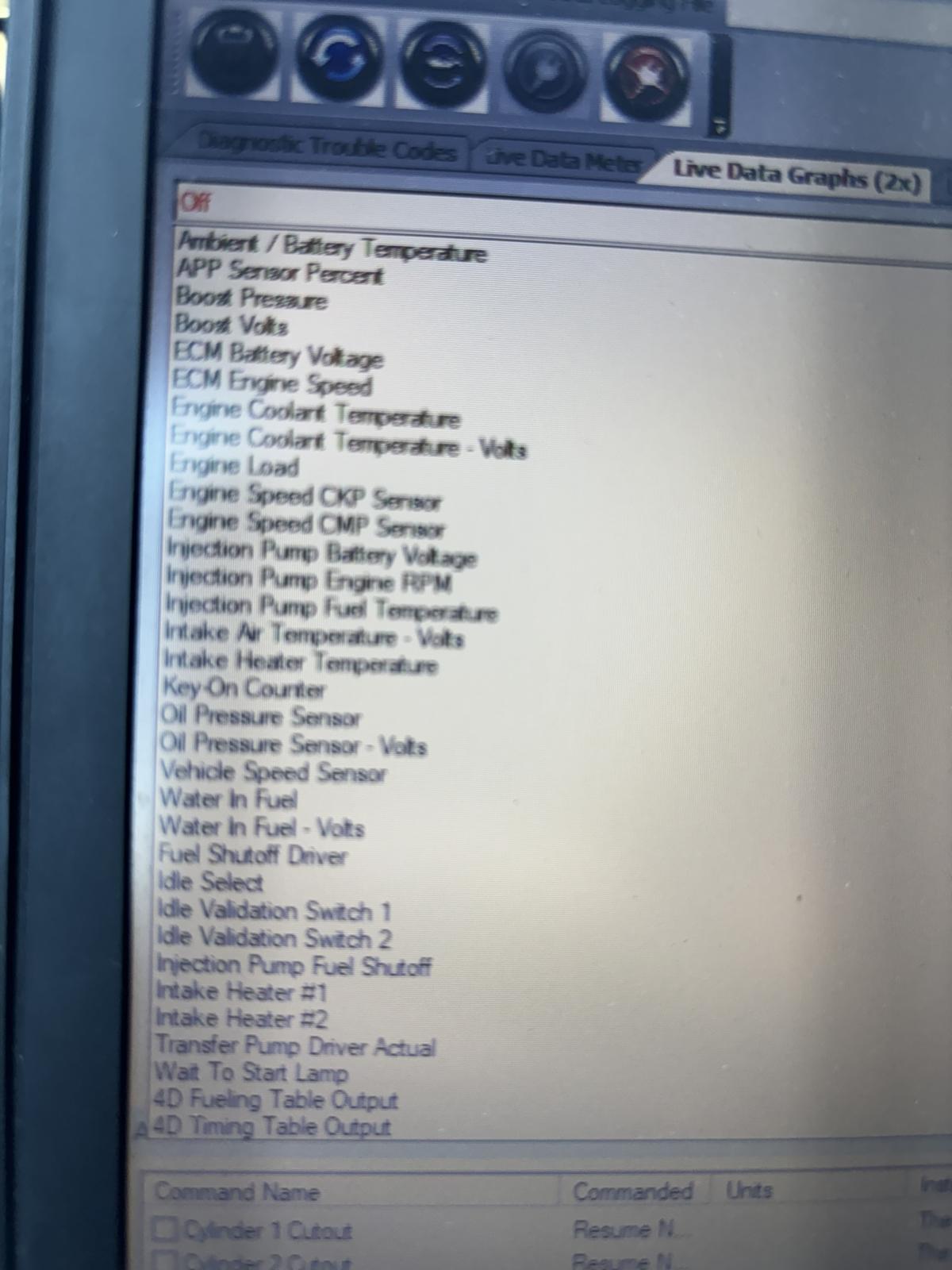

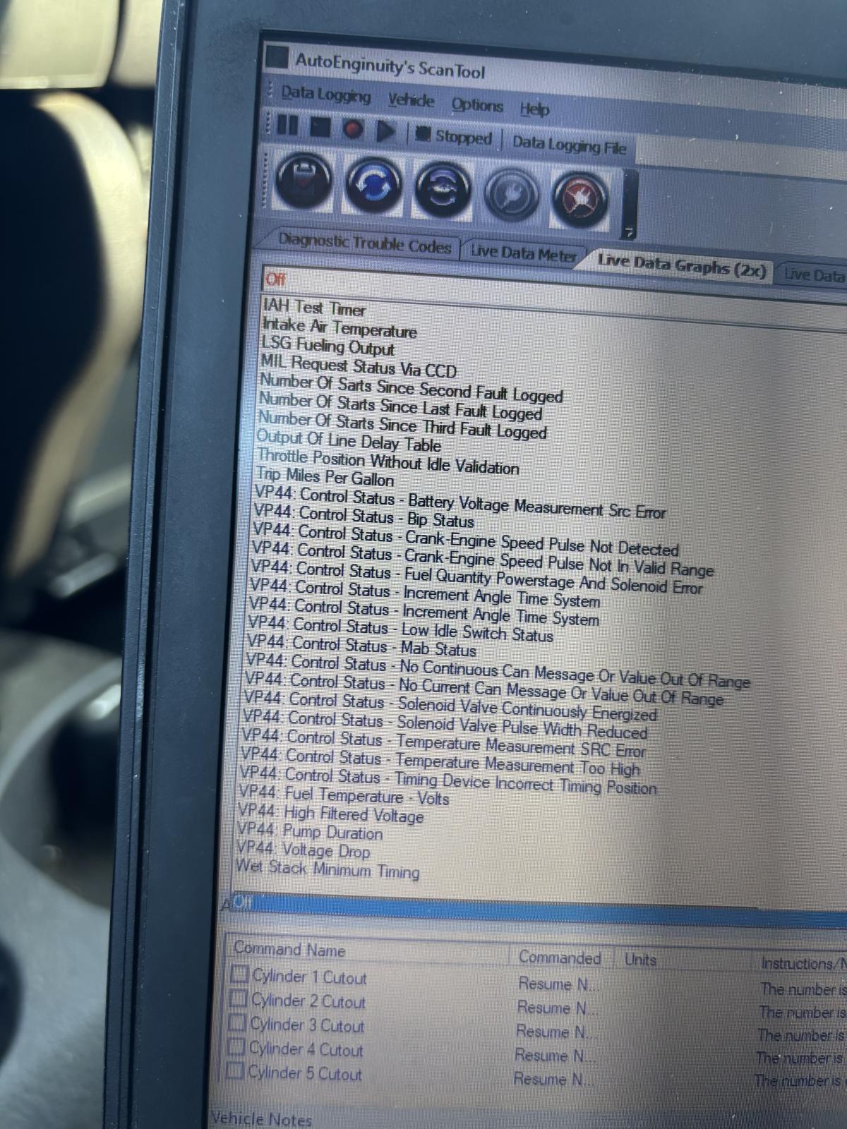

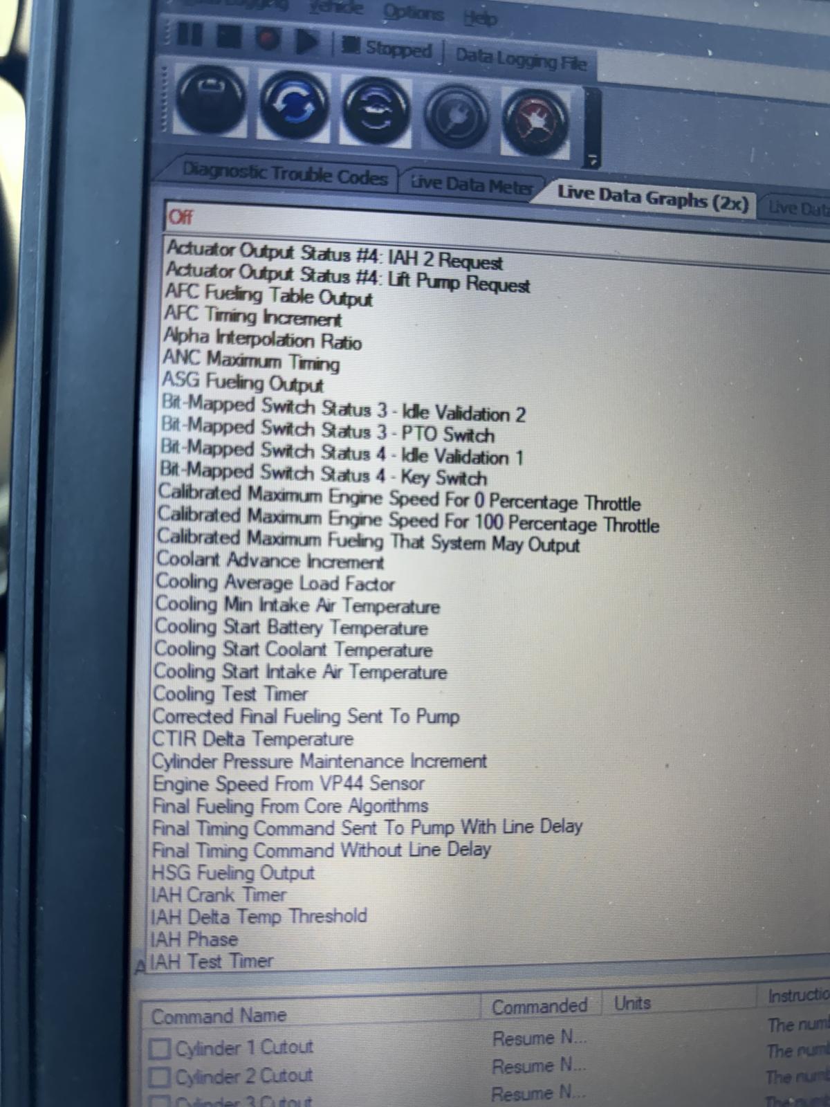

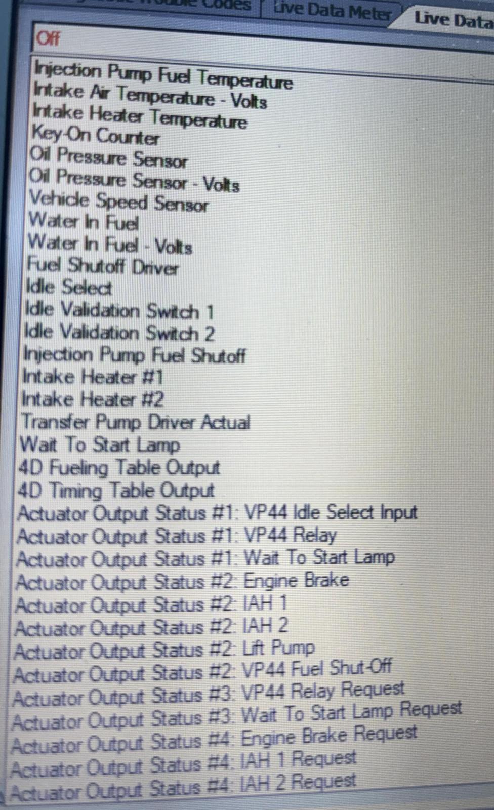

Here are the data logging options for the VP44 on my AutoEnginuity program.
Here are more:
