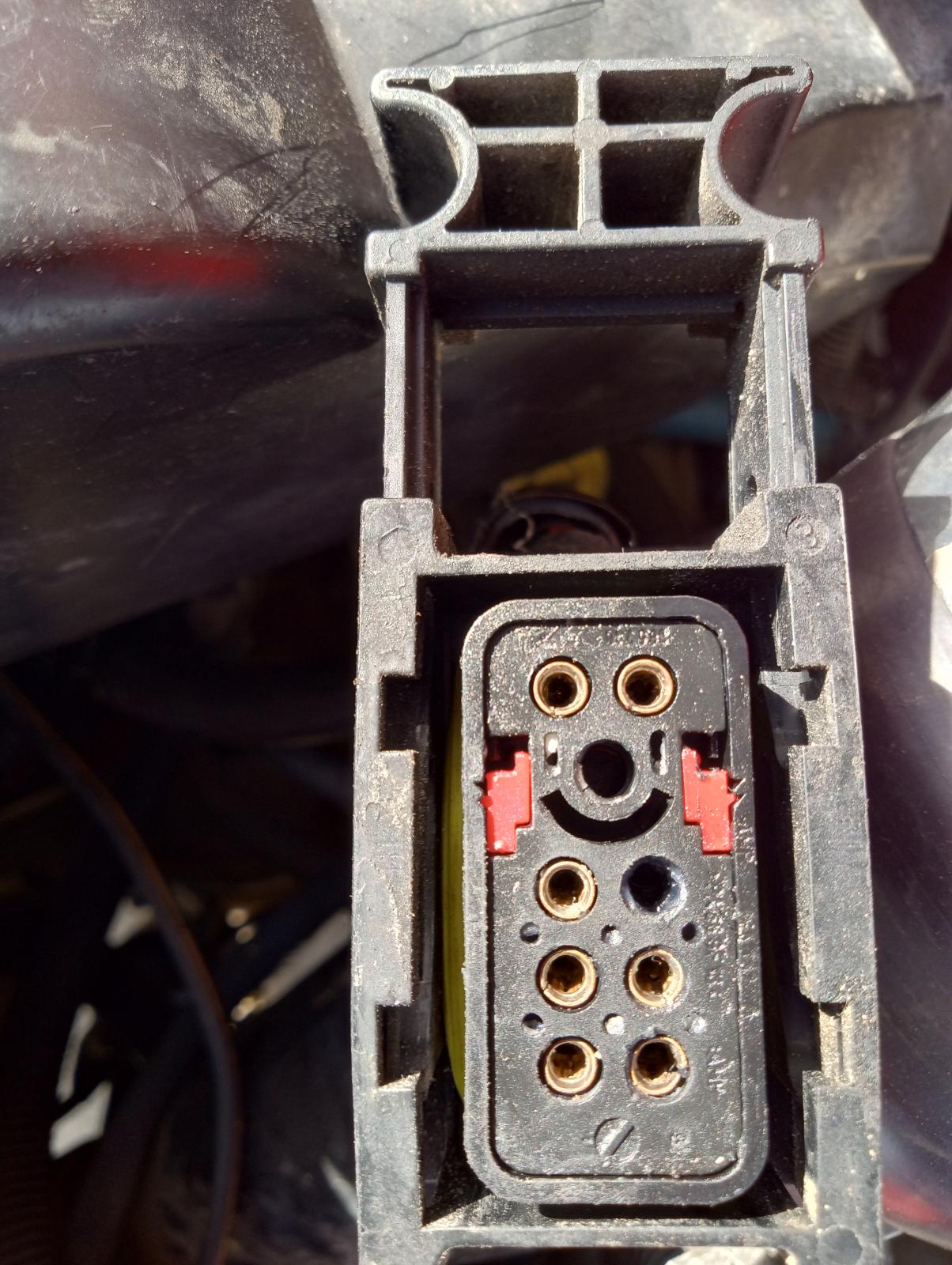

A few days ago I disconnected the harness connection to the VP44 to clean the silicon based dielectric grease and redo it with Motocraft XG-12, which I read was more appropriate for harness connections. I noticed one of the female connectors was sprung more than the others, and appeared to have some corrosion. I sprayed the connectors with Deoxit D5 and ran a brush for cleaning paint guns that was a good fit through them. I then sharpened a pick to be able to get in and pry the sprung connector back together and pushed some 30ga bare wire down into the slight gap between the OD of that connector and the plastic, which held it in place pretty well. Put it all back together. Two short test drives and one longer one today on the highway, getting on it pretty good, one time floored, and it didn't miss at all. Looks like that connector may well have been it the whole time. Sure hope so....
Before pic:

I was using the FSM to figure out what your corroded wire operated. If I am looking at the diagram correctly, terminal #9 should be the culprit. This pin-out says #9 isn't used. Am I looking at the correct pin? Do you know the wire color?
  • John
In my picture above, the problem was the bottom right, which according to the above, would be pin #7
A poor connection at Pin #7 would absolutely match your symptoms, as it is the 12 volt power supply from the fuel pump relay. Keep us posted - hoping you will never experience the issue again.
  • John

You and me both. No fun, and I could have easily never seen it. I'm guessing this is the culprit behind the two fuel pumps that the PO had put in.

I think you would have found it. Your scanner was telling you that you had low voltage at the injection pump. I should have recommended that you check that connection as that connector is part of the battery supply voltage.
You ought to hook your scanner and see if the voltage to the injection pump is now steady and higher than it was. That would help to confirm your find.
