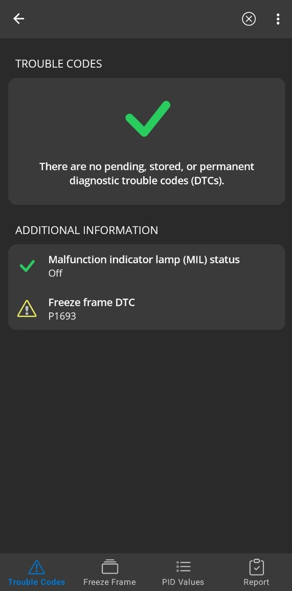

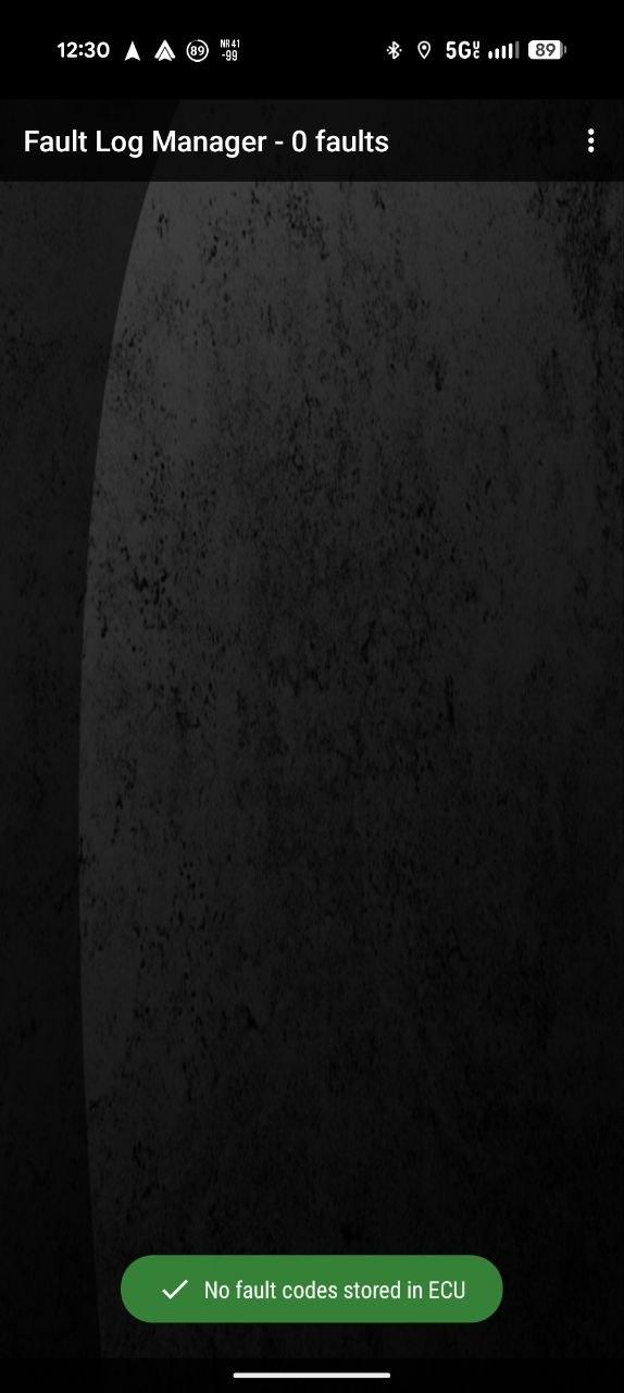

Yes... I think. I have an OBDLinkMX+ adapter, the OBDLink app, and the Torque app. The OBDLink app has supplemental data packs available, but only go back as far as 2006 for Dodge.
Torque reports "No fault codes stored in ECU"

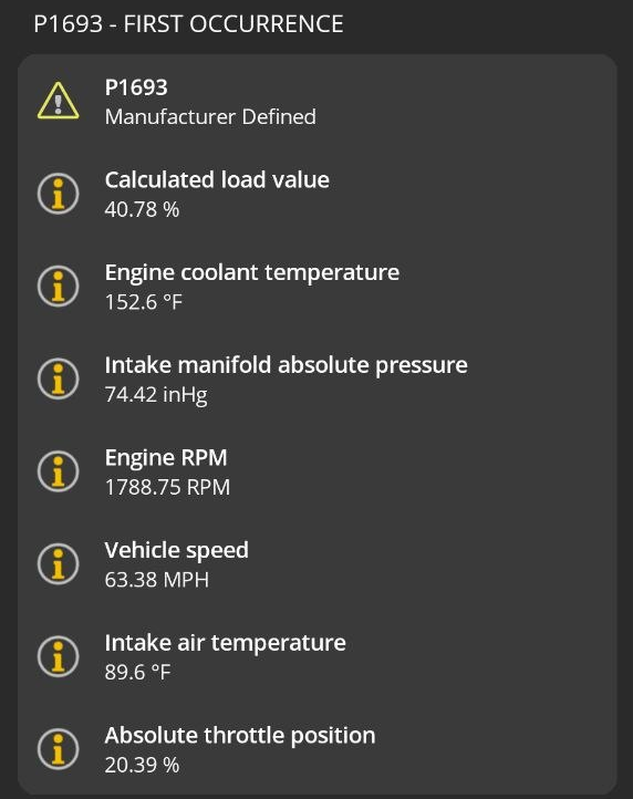

OBDLink reports "No pending, stored, or permanent DTCs", but also shows a 'Freeze Frame DTC' for P1693. It appears to have saved the parameters at the first occurence of that code, and they correspond to normal highway driving. If I had to guess, this would be when the voltage gauge pegged on the low side.

Your app is showing no codes and the key on/off is showing the 4 codes?
Correct.
