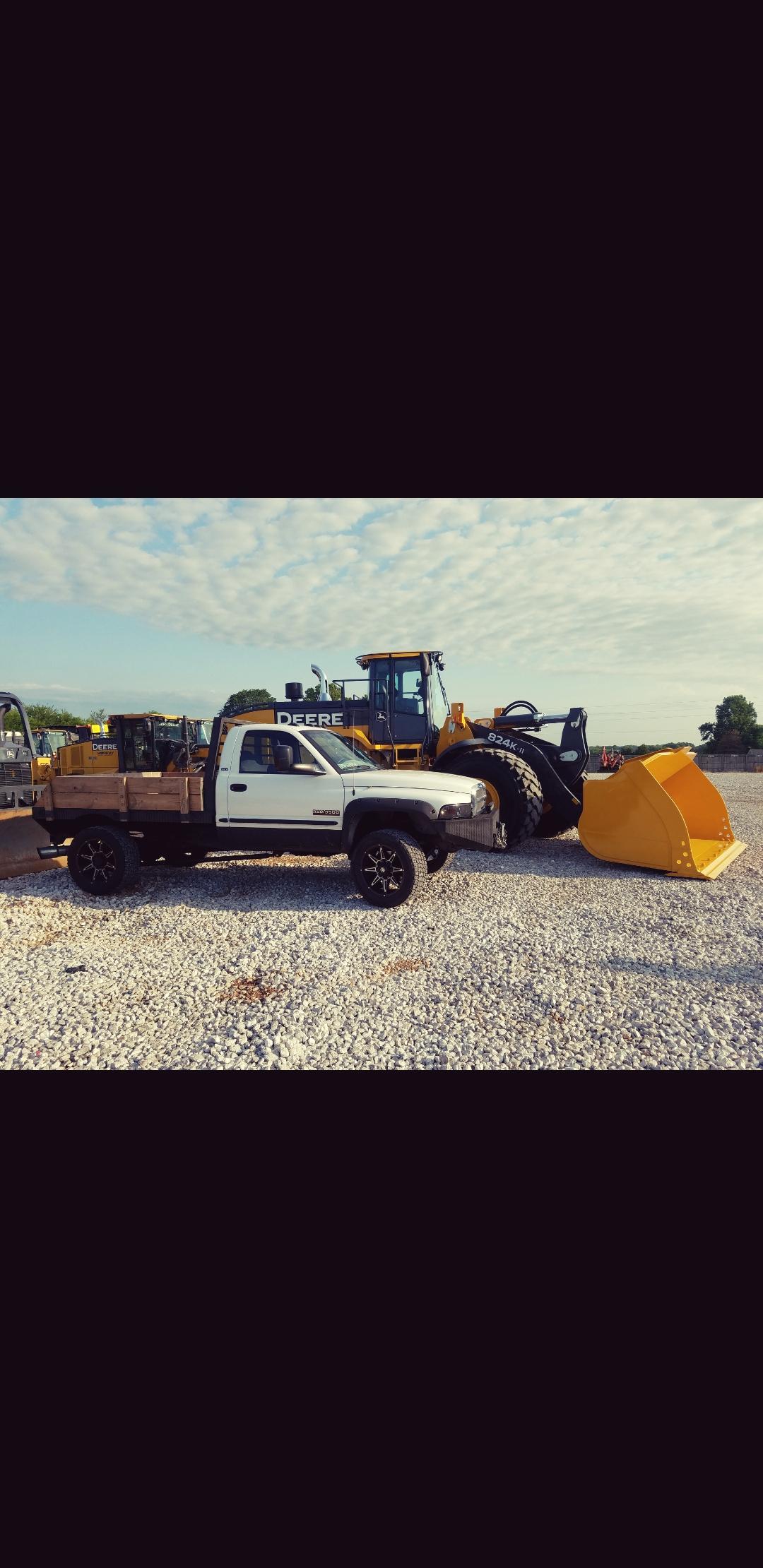

  6. Here are some older pics. I built this truck and redone so much, and its sad to say but shes in pieces now but alot of her parts still live on in the 1500 cummins. Im gonna try and do some video updates/progress on the 1/2 cummins should anyone be interested. She's gonna be sweet!
