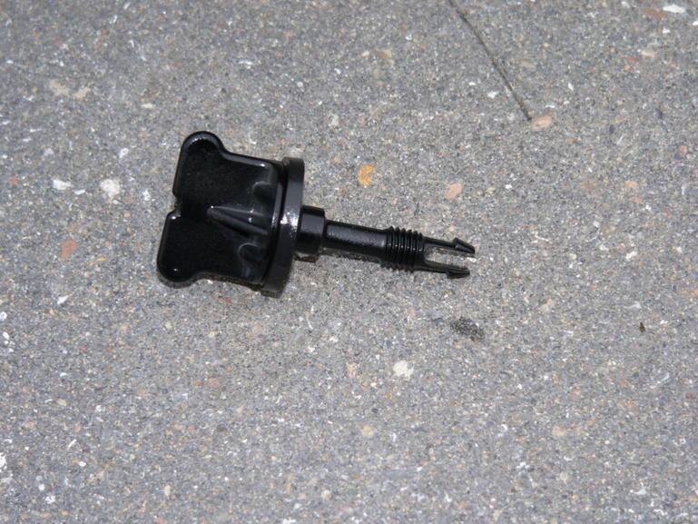

I found a pic of the plug. It has a barbed end on it and it doesn't just screw out all the way. It releases but the barbs keep the plug connected to the radiator. post-10242-138698172357_thumb.jpgOk so as you can see the end of plug has some barbs on the end. So when you install the barbs go thru a hole with some threads in it and then you tighten up the plug and the oring or whatever seals the radiator. So my question is how can you pinch the barbs together in order to remove the plug from the hole so you can replace the o-ring or just the plug it self ??? hope this make sense.Thanks Rob
