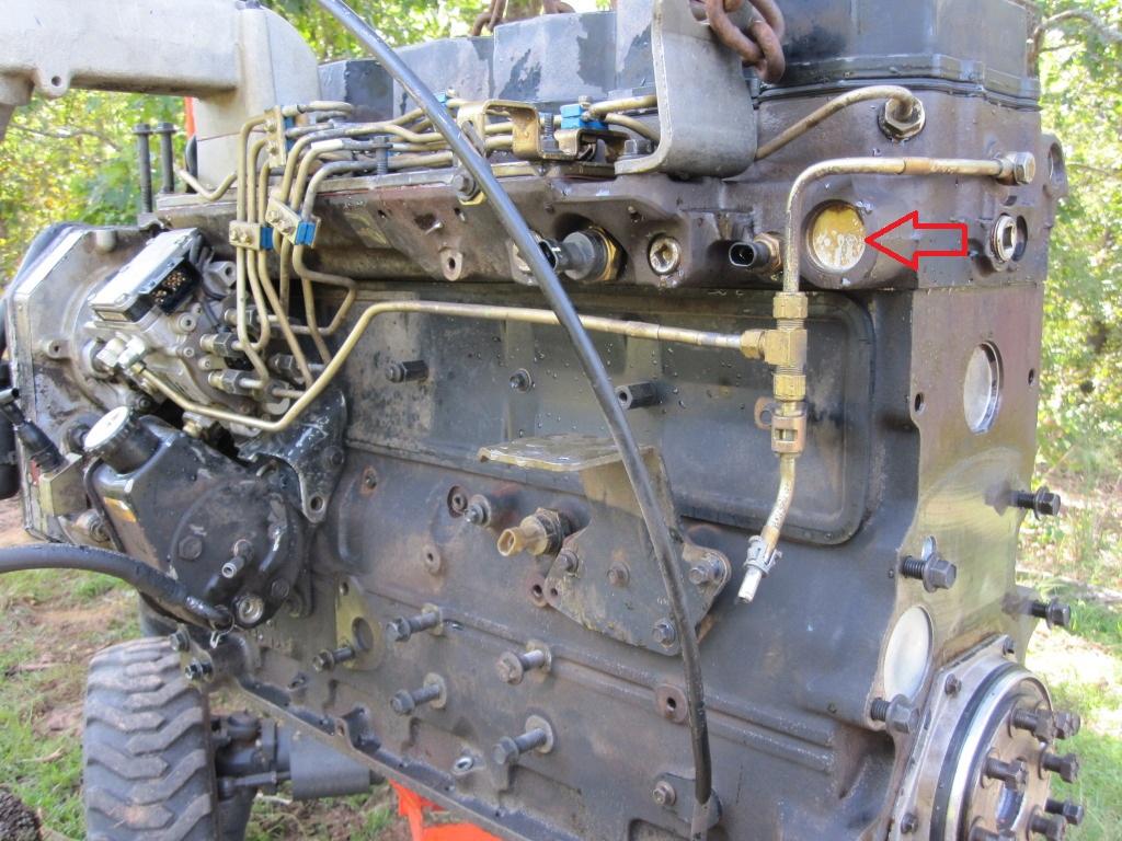

I looked through my pics and I can't even do it since I don't have this freeze plug. I don't even get why there is one in the intake. I suppose it would help a little but how much access to things do you lose with that pipe running over to it?post-45-138698189116_thumb.jpg
You dont have it on the 12v head ? Interesing. I dont think you would lose anything ...... maybe the stock fuel canister. It tees off at the intake tubing and theres not too much in the way there except wiring for apps/vacuum lines etc.

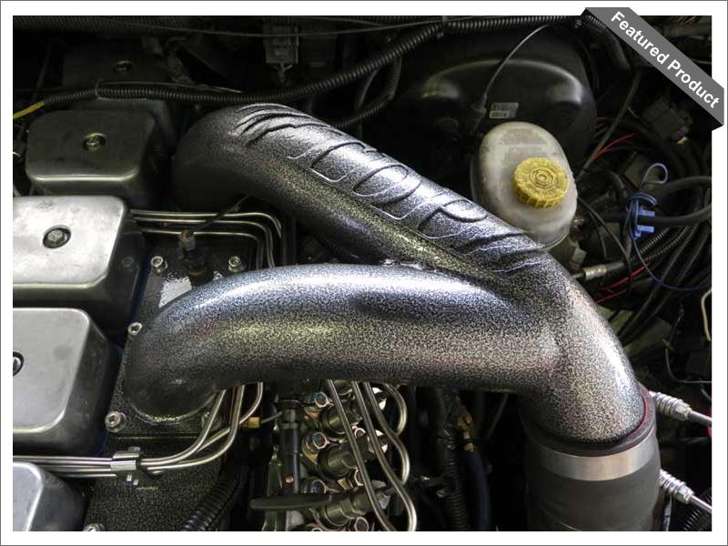

I don't think your going to see much change really... I know there is dual intake horn setup I think by BD that has a new intake manifold plate and 2 intake horns. Also I think it only works on 12V's... But this idea would get better flow than spool aid... http://t2.gstatic.com/images?q=tbn:ANd9GcQd4PM3U3P85luNJBKAn3Y3sp-NdCOP7cUvionszlgGGpBK4hI_z4tfKcE0 post-2-138698189128_thumb.jpg
yeah 12v only But think what a tunnel ram does for you and that's just reduced resistance. Porting on the intake side is meant to help heaps ... but lots $$ Seems for $50 in parts - if you can fab yourself - this could be a significant help - especially to #5 +#6 :) Quicker spool and lower EGT for a stock/mild stock seems this would be a winner Id be up for trying it if someone wants to fab it :)
