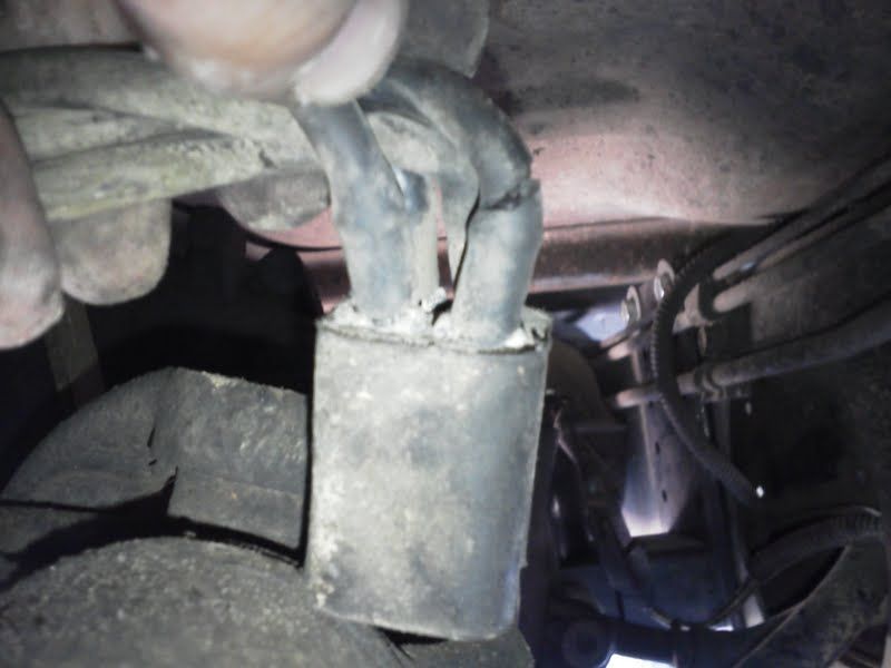

once again... Vacuum leak! It was on top of the switch on the T-Case, Black (4x4) supply line. Cut it off right behind the brake put it back on, put the hose pod back on the direction I found it, and every thing works!!!
Here you can see I took off the Pod (cap thing) with the four tubes going in it, and saw the broken tube.

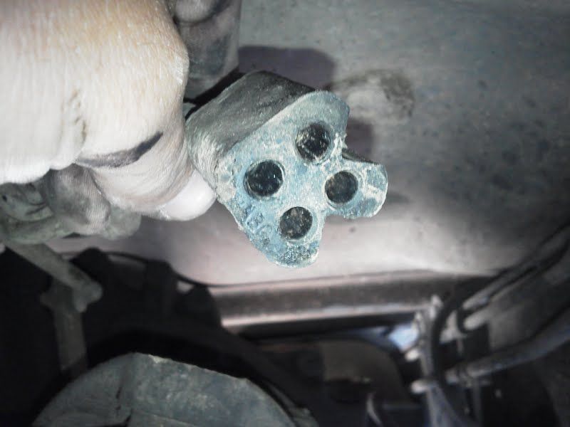

If you want to know what the pod looks like (like I did, and couldn't find a pic) here you are... NOTICE... Two notches on two adjacent sides of the black pod... those tell you which way it was (is supposed to be) facing. It just pulls off the switch, pull upward and wiggle it'll come off.
