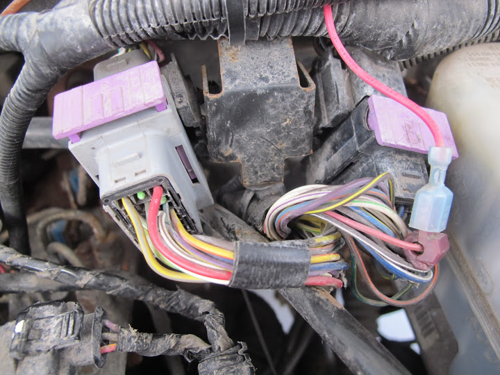

I think I found the problem....There were a couple of harnesses kind of wrapped around the dipstick tube. They were several wires rubbed bare and probably shorting there. I'm not sure they are OEM wires, they may be from some of the Banks stuff that came on the truck?Anyway, the dash seems to be behaving itself now -- we'll see....
Glad you found the issue.
It's hard to say if that stuff is OEM or not, it's a little different than my 05, but the 04.0's were different. I don't see the Banks needing to adjust any of the signals thru that harness.
My 05.
