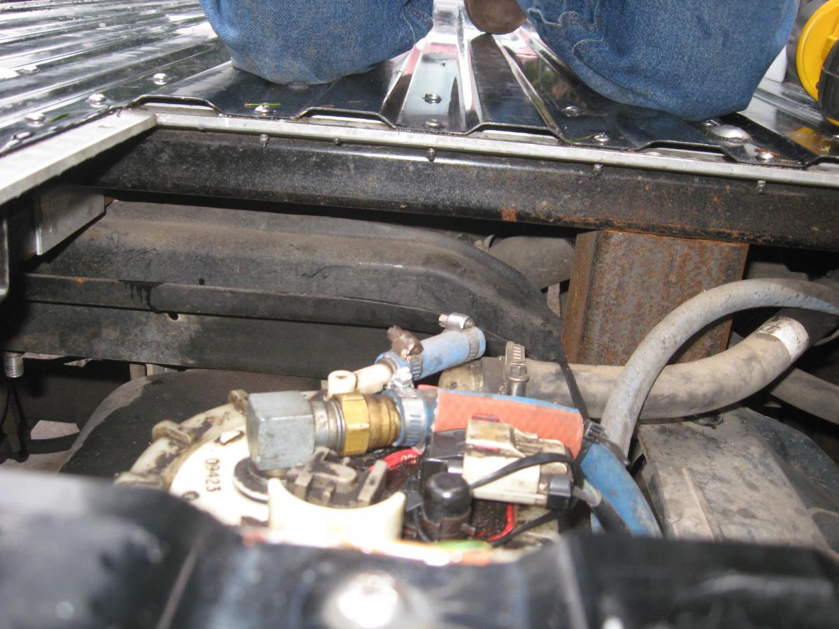

post-669-0-09302900-1391921519_thumb.jpgpost-669-0-54853800-1391921544_thumb.jpgpost-669-0-35031400-1391921561_thumb.jpgpost-669-0-63758800-1391921604_thumb.jpgpost-669-0-03767400-1391921633_thumb.jpg
If you look close you can see how I supported the cut cross member to the bed frame and supported the bed floor. All bolting to the truck frame was from existing factory holes because I didn't want to drill any holes in the truck main chassi.
One of the pics shows my shut off valves to my in line filter and AD100 so I can easily change out either one. There is another shut off valve next to the transfer case to not loose fuel prime too.
Also notice my tall fuel filter has a protection plate. I remove one bolt and it swings out of the way for filter changing.

Forgot this one too :)

Sounds like cutting the hole in the bed is the easy part. But so easy now to pull the tank unit. Can we see your cover plate? Did you weld anything? Or all bolted?
Edited by joecool911
It's all bolted using existing frame holes and carraige bolts thru the bed. I took a small file to square up the holes for the stainless carriage bolts in the bed.
You can see the cover plate (1/4'' aluminum diamond plate) in post #3 leaning up, showing about half of it you can see.

What did you do to seal the metal on the bed cuts to mKe sure it doesn't rust?
I wonder if cap gasket tape would work ok to seal the edges but allow for removal?
I'm no as worried about sealing the bed lid so it won't leak; but rather protecting the cut edges from rusting. Some kind of paint or liquid galvanized paint like used on fencing rails.

I found some Mercruiser boat motor paint and masked off around the cut, laid newspaper over the tank and sprayed away. I will eventually mask and spray all the ss screws and bolts showing.
This is one of those mods that you do if you need a good challenge and with nothing else to do.... well.... I actually relished figuring a way thru this. I went and cut the hole and bed frame first. That way I was forever committed :cookoo::drool:
to getting it done
