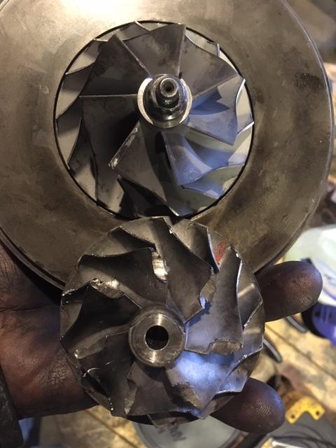

  15. Well I got the new compressor wheel in today. Didn't see any drastic changes in EGT or Load% but there was some improvement. The guy at the shop where I got my injectors rebuilt said to expect to burn through a little extra fuel in the first 10,000 miles so I guess I'll just have to be patient. The improvement in power was DEFINITELY noticeable though. YEEHAAAAA!!! Ignore the tooling marks around the outside of the wheel that was just me trying to get the wheel off without pulling the whole cartridge. I use a diaper rash paste to check the alignment when I set up ring and pinions, it's basically fish oil with a zinc additive. Would this be a safe substance to use to wipe a little around the tip of my fuel tubes to check the seat in the injectors? I just recently read the specs on torque for the fuel line/fuel tube retaining nut and I grossly overtightened them. I don't have any specific reason to want to check but I'm a bit of a worry wart and even more of a perfectionist.

  20. On second thought I think I'll just replace the wheel for now and upgrade to a VGT in the future. Think that'll make me happier for top end and spool up. Thanks

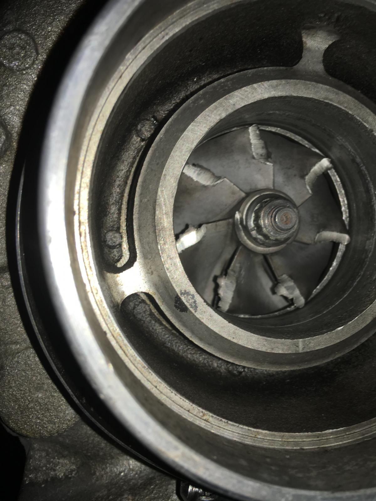

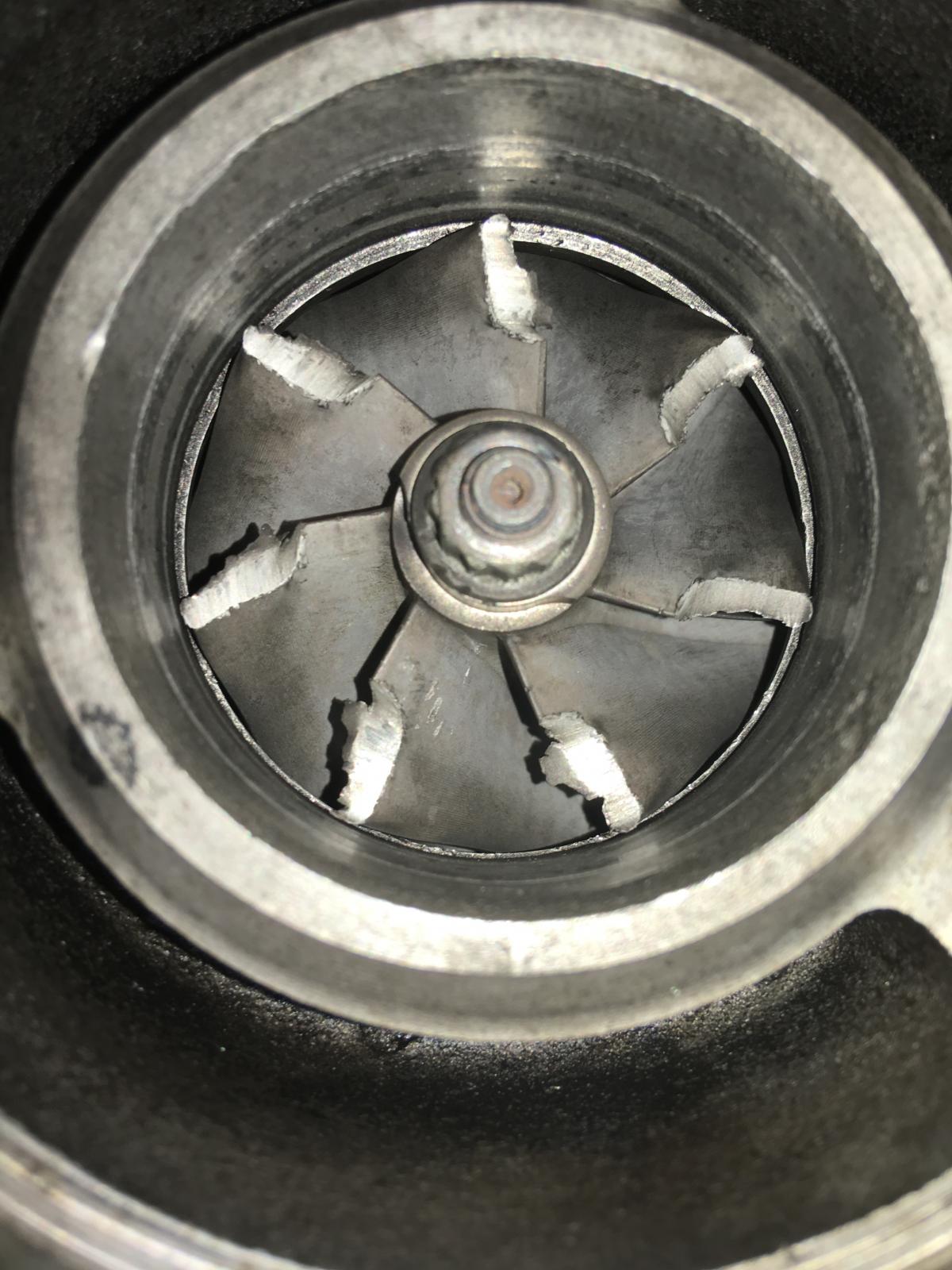

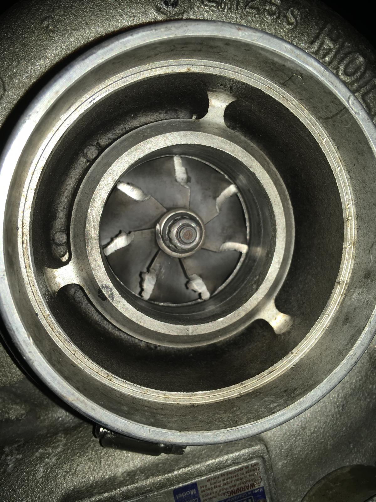

  21. OK I've had my injectors rebuilt and matched and chased down multiple boost leaks. My load/egt numbers are still pretty high and I haven't seen a marked improvement in fuel economy. I observed a couple weeks ago when I started on this quest that my compressor wheel had sustained some damage. I think SOME damage may have been a serious understatement. Judging by the pictures, would this be a possible source for my problem? I noticed recently that even under FULL acceleration I couldn't get 30psi. Assuming that at least most of my leaks are gone, should this be my next focus? That being said what would be the best way to fix this? I can get a replacement wheel on Amazon for $40, a whole new hx40 with t3/t4 adapter on eBay for $220, or an hx40 wheel/housing combo for abot $180. I know there would be some adaptations with the second two and maybe some turbo lag which I could probably adjust for slightly with the Quadzilla. I'm happy with the power I have now but do plan on using her for a towing rig in the future and it feels like the bigger turbo should help with EGT's, but if that's not going to be significant then I'll stick to stock. Keep in mind I have a Cummins/Allison combo in a '96 GMC so adaptation is the name of my game. Thoughts?
