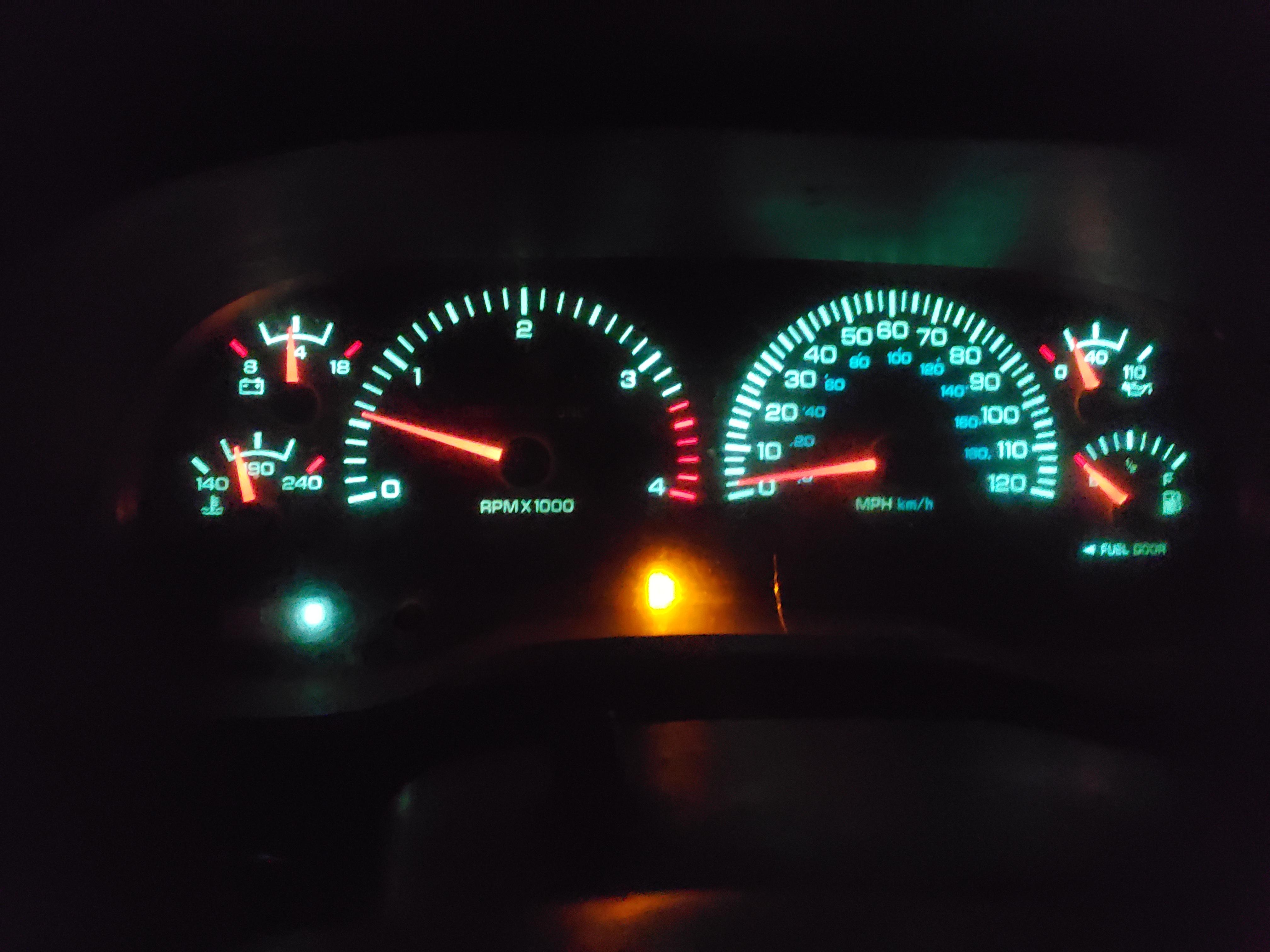

  2. Ok so upon pulling the cluster, checking the circuit for breaks and what not this caught my eye..I believe I traced this circuit down to the LCD connection on back Also the bars connecting the LCD screen that's soldered in. Two were touching...inside the screen there's a blotch, kinds like a bulb exploded or whatever..new cluster coming soon.. Tried the VP44 hotwire, I have good fuel flow in my line before the VP, idk if it need the back pressure of the injectors being connected or not, but I removed them and there's NOTHING coming out of VP.. Like. A. Drop. Maybe.. I touched the hotwire, with split spade connector, likenthe Blue Chip article said...and all I hear is a 'click'..no whirring, no buzzing, no spitting fuel...any ideas? I want to take the tubes and injectors out and throughly clean them....I really want to replace the nozzles and the tubes altogether...but not trying to waste money when it did run before.. Looking to pull the VP computer and check for the bad solder... half a million miles on this Beast.. please help me get it back on the road

  8. Head gasket seems good, and after the te gasket on oil filter housing, aka engine oil cooler as well, if had the truck turn over and start once, but I had no pedal then it hasnt cranked and batteries got weaker..no milky oil yet but it hasnt been to op. temp either... Diagram for hit wire tap on VP? Ps. 512000 is ACTUAL mileage, but now that display wont light up, the '0' in the above pics is last time it did anything...which madd me think comp was rest or something somehow...
  9. No I have the wires all together, except the column which is just exposed cause I was checking for crimped/ broke wires, I only had the fuel up for the coal. I have since turned it back stock. As far as the trip pin, that part won't light up AT ALL... which has me thrown off.. I do not have the dash lights you see in the photo The relay will do countless clicks, not one or two, but that's with any relay I put in there..
