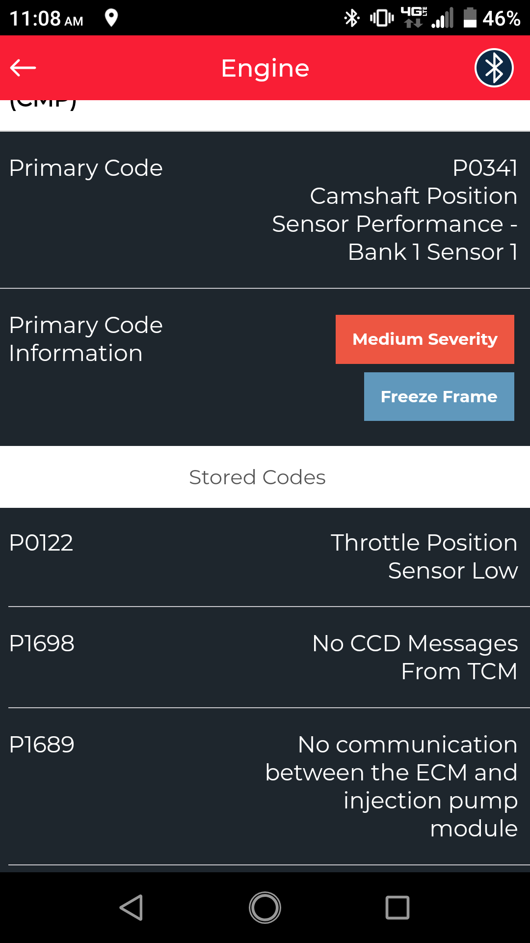

  5. its not that's the reson i made this post reman but i cant run it because i dont have a working fuel supply system and i' ve been busy with helping my dad with getting our non mopar c*ap going, and i wont have time till around lunch time not at this time yes, which are that the ecm would trigger tps codes as soon as you turn it on (key in the "run" position) (i can see, with my scanner under what conditions the code(s) were triggered) and even with a new tps i could not adjust the base volts, or get any tps percentage when monitored with scan tool live data ive checked every wire associated with the vp,map,and tps,
  6. it was when i got to working on the truck but not any more But i haven't tried with the reman because i don't have a fuel supply and it did trip a high and low volt code for the tps
