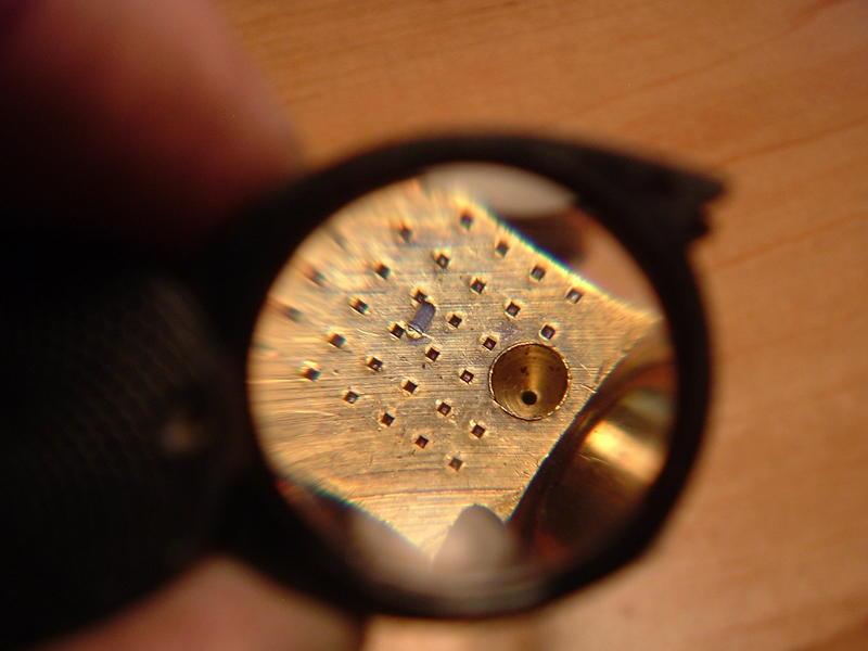

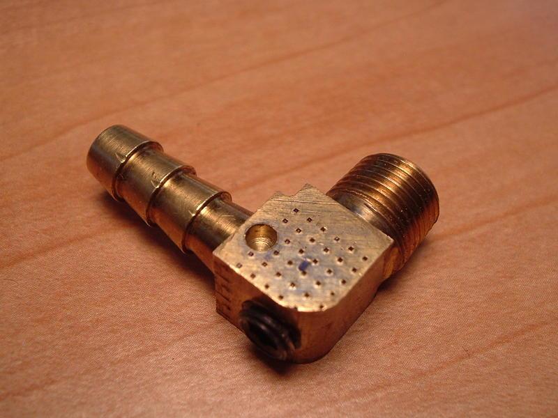

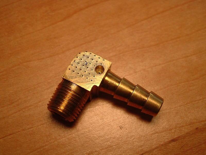

After clamping my wastegate and seeing how much quicker it goes over 20psi, I think I want to try a boost fooler so I can get up to 35psi quick but not go over 35. Anyone want to sell me one or know where the cheapest one is? I found one on ebay for $16.50. Figured I would see if any vendors sell them.
The problem with those is the fact they are extremely hard to adjust just a 1/16 of a turn can mean 10 PSI jump or loss... The one given to me I going to try and modify slightly to improve adjustability... What I'm using is a Edge elbow now and I can hit 35 PSI just about every time...
I can cope with tedious adjusting, I just want the wastegate to stay shut until I finally do hit 35. I think I could be 5psi higher when above 23psi wastegate if it stayed shut since I will have full flow going to the turbine rather than half of it being dumped. I would like to have more boost to control EGT's better but obviously don't want to go over 35. I am just thinking the boost elbow will make it to where I am at 30psi instead of 25 so the EGT will be lower and I will have a little more power.

Hmm, more I read about it the more evident it is that it just slows the rate the wastegate opens, not so much limiting max psi. Tell me if I am wrong, but I think the elbow reduces the air flow to the wastegate and therefore it just slowly builds enough pressure to open the wastegate? So it doesn't limit the pressure at all, it will eventually still open at 23psi, but will take longer depending on the adjustment screw, allowing me to hit whatever psi and then watching it dwindle back down to the 30psi I got with the wastegate hooked up. Am I right? If that's the case then it's not what I want. I want it to go to 35psi and stop.

An elbow seems to just slow a wastegate down from opening, but doesn't it still end up fully open eventually because it's not like it regulates pressure, but just slows it. A pressure regulator would theoretically work, but would still be giving the wastegate pressure as it builds up to 35
The basic thing in all of it is I just don't want the wastegate open, at all, until I hit 35. In my opinion, I want to be building as much *useable* boost as possible, before finally hitting the limit. I don't want the wastegate opening because it takes away flow and prevents me from seeing optimal boost pressure sooner, and I can only hit 30 with the wastegate working like it is now.
However, I might be wrong, I am just guessing how the elbow works, never seen one, never messed with one. From what I understand, you turn the screw out and that lets air flow into the wastegate hose easier and so it opens sooner. If you tighten the screw, flow is harder so you have time to see high PSI, but can watch the pressure slowly drop as the wastegate opens because the line will see that pressure eventually no matter how much you try to restrict it (unless it's completely blocked of course). Am I thinking of this correctly?

Ok now I see. What you are adjusting is the amount of air it bleeds out into the atmosphere, just like a pop off valve. Hmmmmmmmmmmmmmmmmmm, yeah I still would rather it leave the wastegate completely shut until 35. Let me try my crazy idea first. Think I have most of the parts I need laying around.
The setup you are going for is much like the solenoid setup on a HE351, and from watching my boost gauge it's more of a all or nothing, since the solenoid opens at ~32 psi and the WG is a 22-24psi WG, As soon as the solenoid opens the WG goes full open, dumping a ton of exhaust and the boost drops 4-6 psi almost instantly (unless towing then 2-4), then it builds and holds about 28-30 when empty and 28-32 when towing.. From what I gather with a adjustable elbow you can adjust the air going to the WG so it opens smoothly and slowly at the designated pressure. So you can set it to start opening around 32, which makes it fully open about 35psi, and I think will do a better job of regulating. And even thou the WG opens at 23 psi the hole in the elbow lets the pressure off and the set screw adjusts the flow to the WG, so you can have 35psi in the tubro and only 23 at the WG. Another option for you would be an adj psi switch and a WG solenoid from a HE351. All you would have to do is figure out how to get a bung into the cold pipe.. Or run a HE351, they r cheap!What is the DP on a HX35 at 35psi?
The setup you are going for is much like the solenoid setup on a HE351, and from watching my boost gauge it's more of a all or nothing, since the solenoid opens at ~32 psi and the WG is a 22-24psi WG, As soon as the solenoid opens the WG goes full open, dumping a ton of exhaust and the boost drops 4-6 psi almost instantly (unless towing then 2-4), then it builds and holds about 28-30 when empty and 28-32 when towing.. From what I gather with a adjustable elbow you can adjust the air going to the WG so it opens smoothly and slowly at the designated pressure. So you can set it to start opening around 32, which makes it fully open about 35psi, and I think will do a better job of regulating. And even thou the WG opens at 23 psi the hole in the elbow lets the pressure off and the set screw adjusts the flow to the WG, so you can have 35psi in the tubro and only 23 at the WG. Another option for you would be an adj psi switch and a WG solenoid from a HE351. All you would have to do is figure out how to get a bung into the cold pipe.. Or run a HE351, they r cheap! What is the DP on a HX35 at 35psi?
