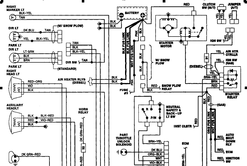

Wiring diagram is a bit crude but it should help out...post-2-138698182238_thumb.pngSo check the starter relay and then check to see if there is 12V from the yellow lead from the ignition switch... It might also be a safety switch like clutch or auto trans safety...
Thanks for the replies, very helpful.I found several pics of a starter relay, but haven't found one on the truck. Could I get a hint where this is located?On the right side of the wiring diagram is a rectangle marked "31". Is this a fuse or fusible link? Any idea where this is located?Thanks again.
From the starter relay connector (starter relay removed), I have 12V when the key is in START on the yellow wire, from the ignition switch. I also have continuity from the starter relay connector to the starter solenoid terminal (brown wire). So the starter relay ($12) is suspect, and I will replace that next. It looks to be original. and I haven't replaced it in the last 10 years.
