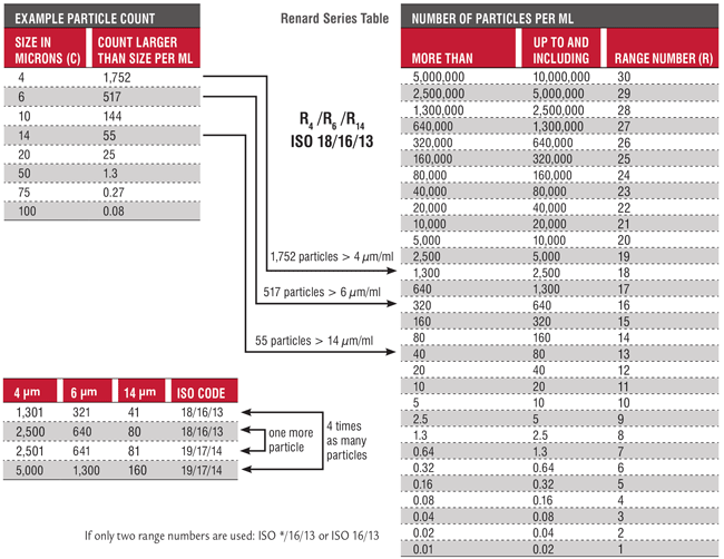

For those who may not understand ISO cleanliness codes, they refer to values on a Renard series table in conjunction with particle counts of a specific micron size. For instance, in a two-digit ISO cleanliness code, particles of 4 and 6 microns are counted. A corresponding value is then assigned based on the number of particles of a specified size and where they fall on the table.
As you can see from the illustration above, there is a significant difference in particle counts between a code of 14/11 and 23/20. Keep in mind that these numbers are for packaged lubricants. For bulk deliveries, the numbers are much worse, running from 20/17 to 28/21. To get a better understanding of what this means, consider that a 50-gallon-per-minute pump moving a lubricant with an ISO code of 21/18 will pump approximately 6,784 pounds of dirt in a year.

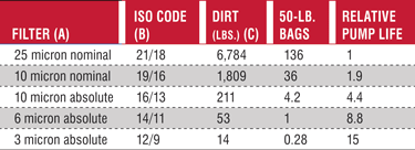

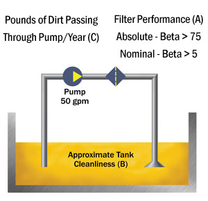

In addition, it has been estimated that one particle of dirt has the potential to generate six wear particles. Particles in the 4- and 6-micron range are most damaging to your equipment because they are the same size as your lubricant film.
Of course, someone has to pay to remove this dirt from the lubricants. You can do it, or you can work with your vendor and split the cost. You may even be able to get your supplier to deliver lubricants that meet your cleanliness targets. This is something you should take into account when your supplier contract comes up for rebidding.
